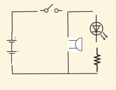

Step 1: Circuit Diagram
This circuit incorporates a battery, resistor, LED, buzzer, and switch. The circuit diagram above displays how the circuit works, with both LED and buzzer turning on upon the switch being "switched on".

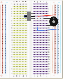

Step 2: Switch and Buzzer
Start by connecting your switch to the breadboard. For my example, I placed the switch on column f, rows 5-7 of the breadboard.
From there, I connected the positive end of the buzzer(long leg) to pin 7, and the negative end of the buzzer(short leg) to pin 10.
To connect the positive rail, I used a double ended jumper wire from pin 6(middle pin of the switch) to the positive rail of the breadboard.
To connect the negative rail, I used another double ended jumper wire from pin 10(short leg of buzzer) to the negative rail of the breadboard.
Now, the buzzer has a complete connection.

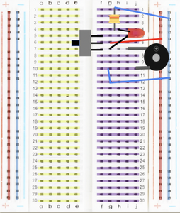

Step 3: Adding the LED
It is now time to add the LED to the morse code circuit as well.
Start by connecting the positive end of the LED(long leg) to pin 7. This will be next to the switch and one side of the buzzer.
The negative end of the LED(short leg) will go to pin 4, or any other pin that has NO connections thus far.
To add the 120 ohm resistor, which will help limit the amount of electricity going to the LED, connect it to the negative end of the LED. The second end of the resistor should go to the negative terminal of the breadboard.
Congrats! The LED is fully connected as well.
