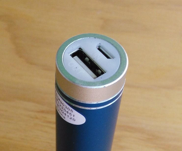

The Arduino can either be powered via the barrel connector (12V) or via the USB connector (5V). I prefer to use the 5V USB connection and either a wall-wart 5V Power supply or a 5V USB battery pack for portability.
