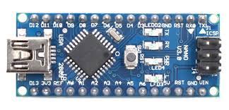

1.Arduino Nano

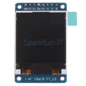

2.ST7735 or 64X128 Oled display

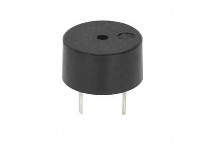

4.passive buzzer

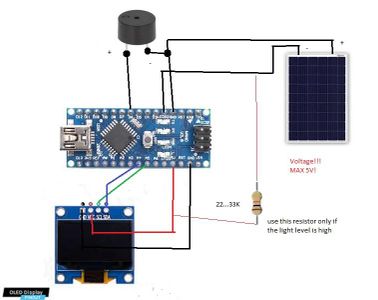

Step 1: Schematic Diagram
Two types of display can be used in this project, an SPI ST7735 model or an Oled 64x128 model. Both schemes are attached, for each option chosen.
The electrical diagram shows the presence of an optional resistor. It is installed when using the device when the light level is high. Used in the evening or at night, this resistor is not mounted. Its value varies depending on the mini solar panel used and varies between 22...33k.
- Attention: the solar panel can be recovered from various toys, but it must not exceed the voltage at the 5-volts terminals in strong light in order not to destroy the Arduino board.
- You can also use a panel with a higher voltage at the terminals by using a resistive divider between its terminals and the Arduino board, but a mini solar panel is easy to find and most have a voltage of less than 5 volts.
- Notice in the electrical diagram the connection of the solar panel with the Arduino, the + terminal to GND and the - terminal to D2
