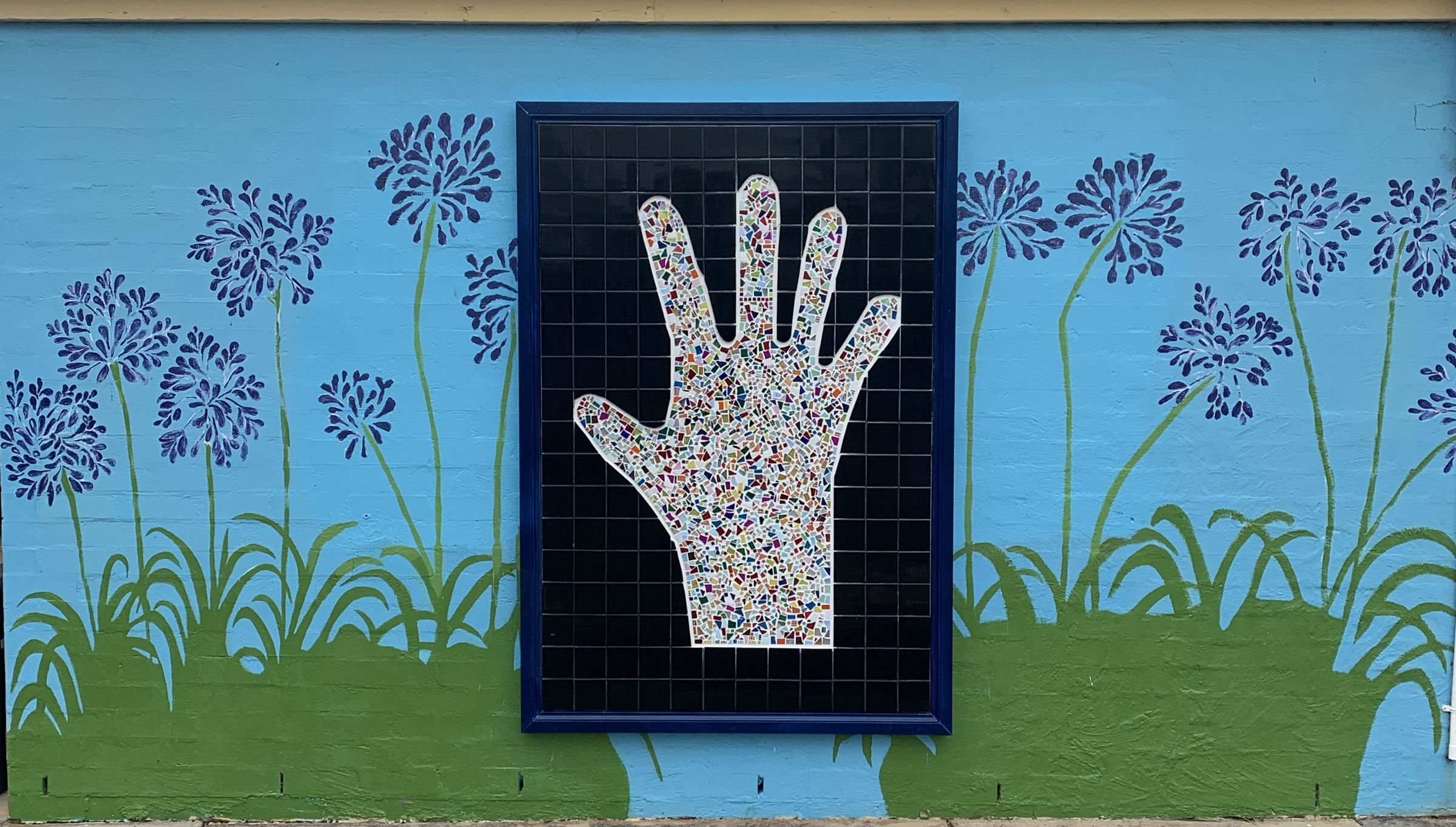

Step 8: Finished Product
Once ours was finished we made a wooden frame and hung it on the wall.It looks so great and we've had so many positive comments about it ! I would definitely recommend giving something like this a go ! The skills involved aren't super hard and things don't need to be super accurate which is great when you're starting out. It's so rewarding and lots of fun ! give it a go whether it's a project on this scale or just a little table or small tile. Its well worth the effort to have something you can proudly say "I made that!"
