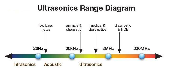

Step 3: How Repellent Works:
Male mosquito emits ultrasonic waves to in the search of food. When these waves came in contact with any female mosquito, she find a place to hide or to fly back to other area. Using the same idea we can create a repellent circuit which can produce ultra sound of the desirable frequency to repel the female mosquito. Therefore, No need to kill the mosquitoes anymore.
Here we are using low power animal hearing range ultrasound to repel the mosquitos because they are affected under a ultrasonic range of 22khz to 40khz. So, please don’t use this circuit if you are a pet owner.
