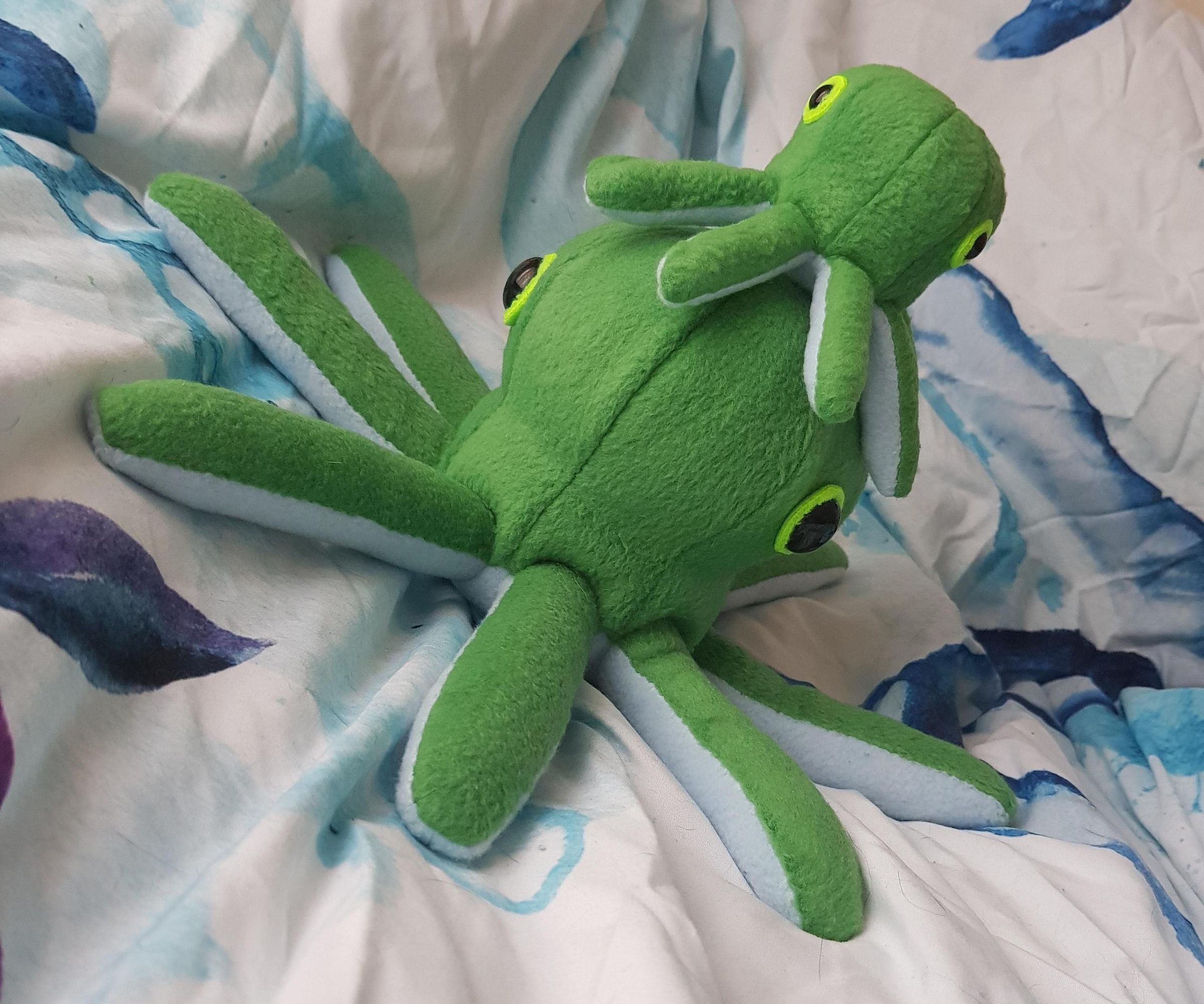

Step 3: Overcast Stitch 2: Electric Boogaloo, or How to Mouth Your Mothman
The mouth is a bit complex, although it uses only the overcast stitch, so I thought I'd dedicate an extra step to it. Basically, you're going to use the overcast stitch to sew the blue mouthpiece onto the top lip, and then again to sew it onto the bottom lip.
I've provided photos of the finished front as well as the back, so you can see what I mean.
