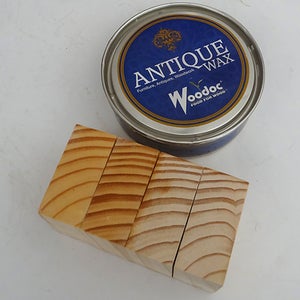

The blocks are cut 69 x 69mm square on a mitre saw.
To make the holes in the blocks it is better to use a MAD bit. I bought a complete set of MAD bits and used a 35mm bit to drill out the holes. A MAD bit has a smaller tip than a spade bit and I find them much easier and safer to use that spade bits.
Securely clamp each block to your workbench before drilling out the holes. I used my Bosch Compact corded drill as the shaft of the MAD bit won't fit into a cordless drill / driver.
I drilled the holes off-centre to allow for easy access to the ring holders when you open and close, as well as for the support shaft. Leave a complete block for the top.

Use 80-grit sanding pads to remove any uneven edges. You want the blocks to line up on all sides. Sand again with 120-grit and then smooth with 240-grit.
Draw your wording on the top box and then use a Dremel VersaTip soldering iron to burn the wood.
Sand the top again with 240-grit and apply a coat of antique wax over all surfaces; leave for 10 minutes and then buff to a satin sheen with a soft cloth.
