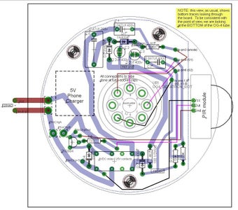

Step 4: Construction
I wanted to fit all this into a small wooden base, originally a
lighted base for glass display. This called for a circular PCB.
(Download Board.pdf for detailed image)
Note that 3 pins of the OG-4 are not used, as they are not connected
to anything internally.

(Yes, I still manufacture my own boards,because it is fun!)
Plexiglass bottom shields access to high voltage but allows access to PIR module for adjustments.
