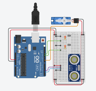

Step 2: Circuit Planning
This circuit diagram was planned out using tinkerCAD circuits. It's an extremely useful tool for planning Arduino circuits - you can even get the code working within the online simulations. This visual is excellent for anyone looking to recreate this project since it can be traced - unlike the god-awful wiring in the pictures :).

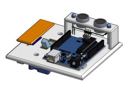

Step 3: CAD Modeling
The 3D model was made with onshape. I did import the .step file into fusion 360 to make some renders. The components were imported from grabcad to test spacings (not crediting here because I have no idea where those links went).
The main housing was designed in a way that it could replace an existing light switch cover. I first used dimensions from a light switch to create that outline, but I extended it outward to make room for the rest of the electronics. The servo's position is as close as it can get to the lightswitch so it can fit with it behind the drywall. The micro servo and the Arduino Uno have screw holes (not threaded), and the other electronics are friction fitted. The extension to the servo did need to be hot glued a little, though, since it was falling off with just the friction mount.

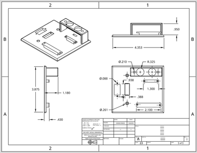

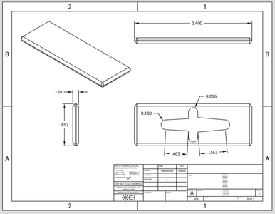

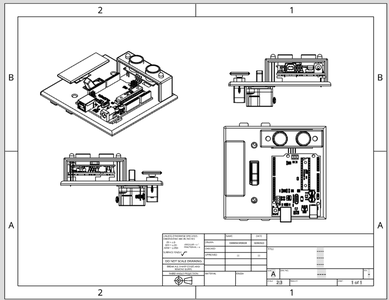

Step 4: Engineering Drawings
Engineering drawings generated with onshape.

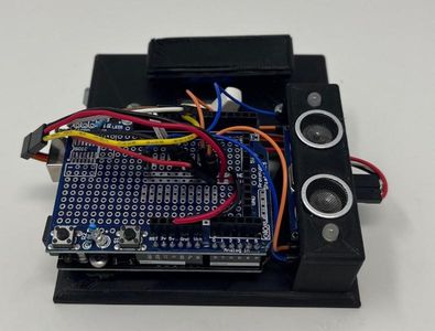

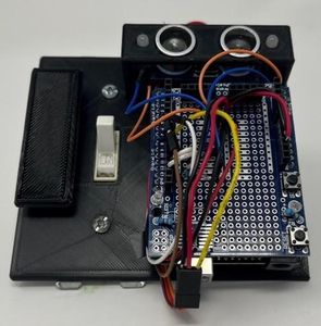

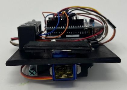

Step 6: 3D Printing, Construction, and Design Iterations
It took me a few tries to get the spacing correct for each part - some of them were due to negligence, and other times to tolerance issues. The hardest spacing to figure out was that for the ultrasonic - ultimately, I needed to drill out the insides a little to make it work, but I fixed it in the CAD if anyone wants to print it and happens to have the same ultrasonic sensor. Although, fair warning, it needs to be the exact one on the parts list since there are a few different versions.
With this project, I also included the protoboard because it allowed the components to be soldered permanently, whereas all the wires won't fling out and ruin everything. Most of the soldering is done underneath the protoboard, so it can't exactly be copied, but following the electrical circuit plan from the tinker cad will serve as a good template.

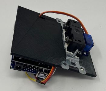

Step 7: Design Limitations
In some instances, the servo is programmed to wind back for more momentum to flip the switch. A more thoughtfully designed attachment to the micro servo would allow more torque to be applied in the correct direction and make this hacky coding solution unnecessary. I also noticed that sometimes the servo attachment could slide over the light switch so maybe the servo itself could be lowered a bit or the attachment could be changed to be a tad thicker.
