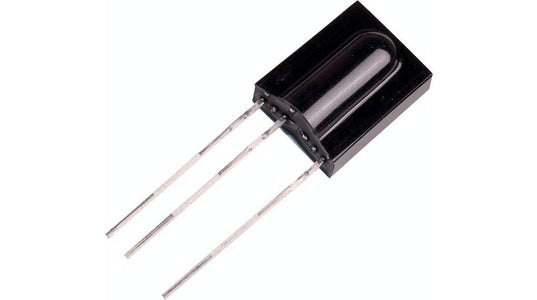

  • An IR Receiver

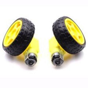

  • 2xGear Motors with wheels

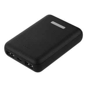

  • A Powerbank with 5V output at 1A (You can use a 3xAA battery pack just to get the high current).

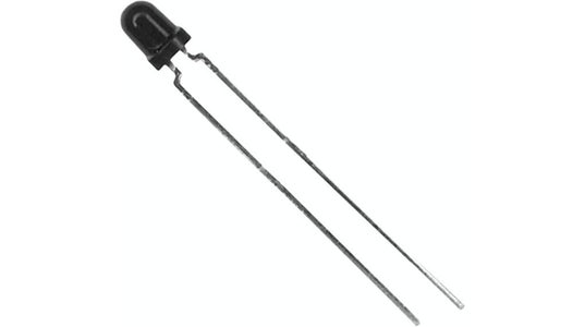

  • An IR LED

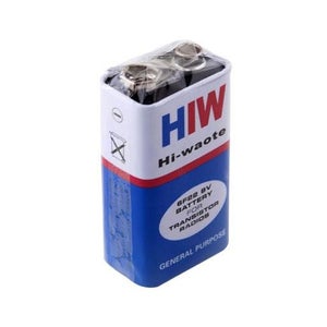

  • A 9V battery

  7. Now connect your IR Receiver to your Arduino by simply connecting the VCC of the Receiver to the Arduino's 5V output.
  8. Then connect the GND of the IR Receiver to the GND of Arduino.
  9. And finally, connect the output pin of the Receiver to Digital Pin 2 of Arduino.

  1. Connect your 9V battery's Positive and Ground Terminals to the +/- rails of the breadboard accordingly.
  2. Now connect the Positive and Ground to the Vin and GND of the Arduino Nano respectively.
  3. Next, you can connect the Arduino's Pin D2 to the IR Emitter/LED's anode. You can put a resistor but since the IR LED operates at a higher voltage, it won't hurt it without a resistor.
  4. Now connect the cathode of the IR LED to the GND of the Arduino.
