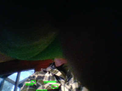

This guide will show you how to create a motion detection application using Python and OpenCV. The application will detect motion in a video stream from a webcam and trigger an alarm that will write a timestamp to a text file, sound an alarm and capture an image when motion is detected. The sensitivity of motion detection can be adjusted, and you can enable or disable the alarm sound and image capture features. The text file and images will be saved to the directory that the code is run from. Let's get started!

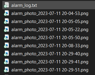

def capture_image(self, frame):
timestamp = datetime.now().strftime("%Y-%m-%d %H-%M-%S")
photo_filename = f"alarm_photo_{timestamp}.png"
cv2.imwrite(photo_filename, frame)

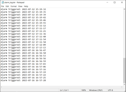

def log_alarm_trigger(self):
log_message = f"Alarm Triggered: {timestamp}\n"
with open("alarm_log.txt", "a") as file:
file.write(log_message)

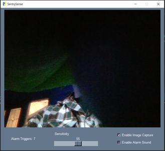

def run(self):
layout = [
[sg.Image(filename='', key='image')],
sg.Column([
[sg.Text("Alarm Triggers: ", key="counter_text")],
sg.Column([
[sg.Text('Sensitivity', size=(10, 1), pad=((60, 5), (10, 0)))],
[sg.Slider(range=(0, 100), default_value=self.threshold_value, orientation='h', key='sensitivity',
pad=((60, 60), (0, 10)))],
], justification='center'),
sg.Column([
[sg.Checkbox('Enable Image Capture', default=False, key='image_capture')],
[sg.Checkbox('Enable Alarm Sound', default=False, key='alarm_sound')],

Step 3: Motion Detection Alarm System
In the final step, we will execute the code and witness its functionality in action. Let's explore how it works:.

  13. capture_image(frame):Capture an image from the frame and save it with a timestamp as a PNG file.
  14. log_alarm_trigger():Log the alarm trigger with a timestamp in a log file.
  15. run():Set up the GUI using PySimpleGUI, including an image element for displaying the video stream, a counter text for alarm triggers, and checkboxes for enabling image capture and the alarm sound.
  16. Enter a loop:Read the current frame from the video stream.
  17. Process the frame using the process_frame method.
  18. Update the GUI elements, including the trigger count and checkbox states.
  19. Convert the frame to RGB format for GUI compatibility.
  20. Update the GUI image element with the current frame.
