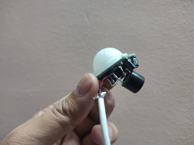

Step 4: PIR Motion Sensor
A passive infrared sensor is an electronic sensor that measures infrared light radiating from objects in its field of view. This type of motion sensor is only the receptor of infrared waves and does not release any infrared beam so they are called passive infrared sensor.
PIR Motion Sensor

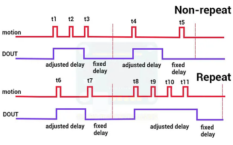

Normal Modes
When the Passive infrared sensor detects motion, it sets the output to High until a certain predefined time by Potentiometer. This mode is independent of the movements during the output HIGH time. In the figure above, t1 is first motion detected. The output go high when the first motion is detected. t2 and t3 are second and third motion detected but in this case the output is not set high as it falls in delay interval. After the output is set for some predefined time there is fix delay. This mode is also independent of the movements during this fixed delay time. The output is set high for the fourth motion (t4) but the output is not high for t5 as it fall in fix delay time.
Re-Triggering Mode
In this mode when the PIR sensor detects motion, it sets the output to High until a set adjusted time but if it detects motion during its output High state 1, it again triggers the sensor to increase the output high period of the sensor.
In re-triggering mode, t6 is the first motion detected. t7 does not trigger the sensor because it is within the fixed delay interval. t9, t10, t11, which occurs after t8 triggers the sensor, extend the time delay since they occurred within the adjusted delay interval.

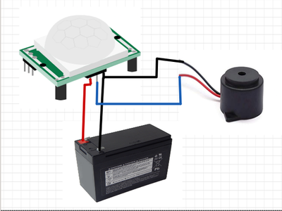

Step 7: Circuit Diagram
circuit diagram of Motion Detector Alarm Circuit
The above figure is the circuit diagram of Motion Detector Alarm Circuit. It has very simple circuit which contian PIR Motion Sensor, Buzzer and power supply.
PIR sensor
Vcc – Positive terminal of battery ( +12V)
Gnd – Negative terminal of battery.
Data – Positive of Buzzer
Buzzer
+VE terminal – Data of PIR sensor
-VE terminal – negative terminal of battery
Step 8: Working Principle
We are using 12 Volt power supply and Buzzer of same 3.3 Volt rating. We know that, If we directly connect our Buzzer to 3.3 volt power supply, the buzzer will Beep. But the objectives of this project is to beep the buzzer only when the sensor detects the motion. If we measure the voltage across the data pin of PIR sensor, we get 0 volt when no motion is detected. so, Buzzer does not beep when motion is not detected . And there is 3.3 volt in data pin, when motion is detected. This 3.3 volt is directly given to positive terminal of buzzer. The buzzer will produce the beep sound when motion is detected.
