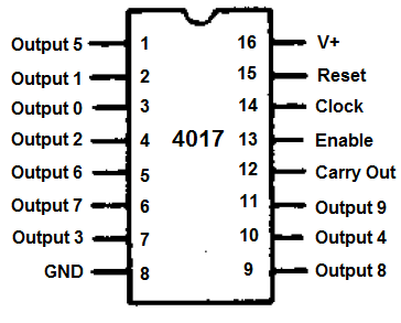

Step 3: Connecting the 4017 Decade Counter
First 4017 Counter:
  • Connect pin 16 to VCC (5V) and pin 8 to ground.
  • Connect pin 13 (Enable) to ground.
  • Connect pin 15 (Reset) to ground for normal operation or to a control circuit if reset functionality is needed.
  • Connect the clock input (pin 14) to the output of the second 555 timer.
  • The outputs (Q0-Q9) will be connected to the Leds
Second 4017 Counter:
  • Connect pin 15 (Reset) to ground or a control circuit as needed.
  • Connect the clock input (pin 14) to one of the outputs of the first 4017 counter if cascading or to another clock source if separate control is needed.
