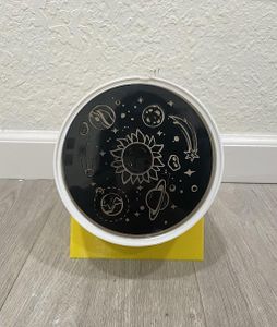

The first picture is a picture of the acrylic with the design when it was first finished being cut. The brown paper is the protective wrapper. The second picture is from when I was in the process of attaching everything, and the third picture is the finished result.

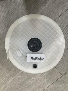

The last step is to assemble everything. I glued the DC Jack in the rectangular hole designed for it in the back lid and I glued the speaker to its designed area also on the back lid (picture 3). I glued the Bluetooth circuit module and breadboard to the inside of the back, so that it would be on the inside of the cylinder (picture 1). I centered the motor on top of the pillar, and put glue on the ends of the motor holder which I put on top of the motor to secure the motor. I glued the motor coupler to the center of the acrylic plate and attached it to the shaft of the motor (picture 3). I also reconnected the circuit in the way I had it set up before after the glue I used for the components was done drying. For all of the pieces that needed gluing, I used Gorilla Glue.

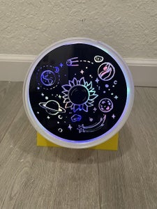

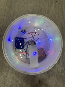

Another variation between my project and the original was that I didn't use an addressable LED strip. I used LED string lights to light up the project, so I hot glued the LED string lights to the inside of the cylinder. I tried to wrap the lights around pretty loosely so that the light would be distributed towards the center rather than being tightly wrapped around the edge of the cylinder (picture 4). I glued the on/off switch for the string lights to the back of the cylinder where the speaker and the jack are (picture 3). I glued it on the outside to make it more accessible to turn the lights on and off.
