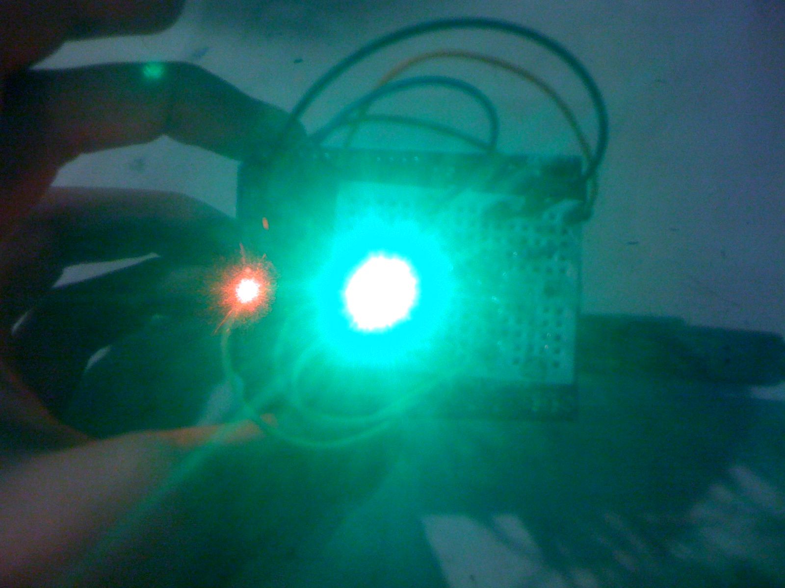

Step 3: The Alarm Motion Sensor
Firstly the sensor is going to need a 12v DC power supply. Connect this to the positive and negative terminals that can be found inside the sensor, and switch on the power supply. The sensor will take up to 2 minutes before it is operational, as it performs a self check each time it is powered up. We will then need 2 wires to connect to NC (normally closed) and C (common).
Next set up the mini breadboard as shown in the diagram. Now, take the wire connected to the NC port of the sensor and connect it in line with the green wire on the breadboard. The wire coming from C is then connected in line with the red wire.
Finally, leaving the dmd connected as it was in the previous step, connect the wires from the breadboard as follows, Green to Pin 4, Yellow to Gnd, and Red to 5V.
And there we have it, all the hardware is in place and now we just need the sketch for the arduino.
