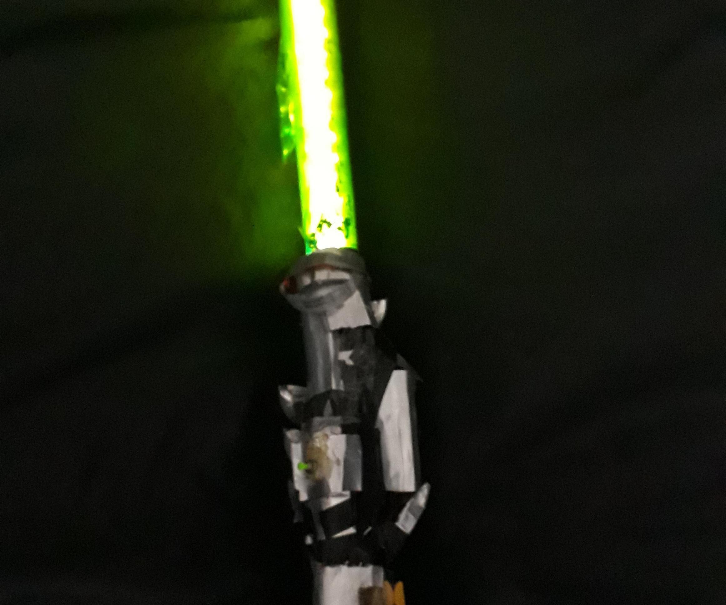

Step 10: Decorating the Lightsaber: Hilt
At this point my Padawan, you already own a game controller, but its not a lightsaber yet, so feel free to decorate your hilt in a way that express your alignment with “the force”, my alignment is with the beer, so I cut beer cans with a big scissors, being carefully in this process.
I left some books above the cut cylindrical pieces to plaining it a little, then I started covering the hilt with it, always in big pieces of aluminum, (some parts may be uncovered after all, so its up to you wrap the hilt with aluminum foil before, just to hide the uncovered parts a little).
If you have any wire passing out of the hilt, or any terminal from a button except for the triggers(they too far from the aluminum, and are isolated by the hot glue)please tape them with isolating tape, to avoid any shocking stuff.
For holding these aluminum parts, isolating tape and transparent tape are a good design choice, i optionally made a case for the analog stick with the cut beer cans.
Step 11: Decorating the Lightsaber: Blade
I only have White colored LED strip, so I wrapped the blade with green colored cellophane paper, with is also a cheap and alternative to buying colored LED strips,
Never paint the blade, just don't paint her, it's not going to glow so well.
