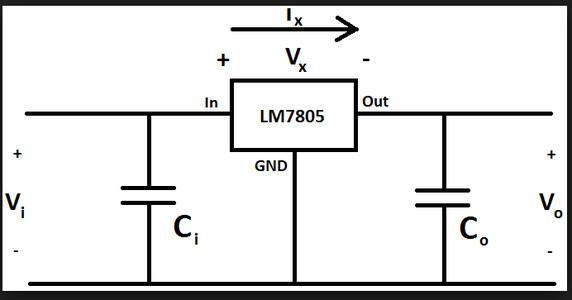

Step 4: Power Supply
I really like these cellphone charger type power supplies. Al-tho this one happens to be from a D-Link router.
I have found they always output more than the rated amount. This is rated at 5v. Actual output is 7v.
After running it through the LM7805 voltage regulator i measure 5.01v output. Just write.

The board is fairly simple with only 8 components.
For the LM7805 voltage regulator i used 2 #104 capacitors. That is not what the book calls for but i have found it works well enough i can not measure the difference with a DMM.
There is a 20 pin socket for the ATtiny2313 to sit in, then a 4K7 ohm resistor from pin 12 ( set as an output ) to the base of a 2N2222 transistor that is used to switch the ground on and off of the LED's. The positive side of the LED's are always connected to VCC.
Pin 14 is an input for the PIR sensor.. Pin 10 is ground and pin 20 is VCC.
The voltage regulation is set up like in the picture.
That's it, 4 connections.
