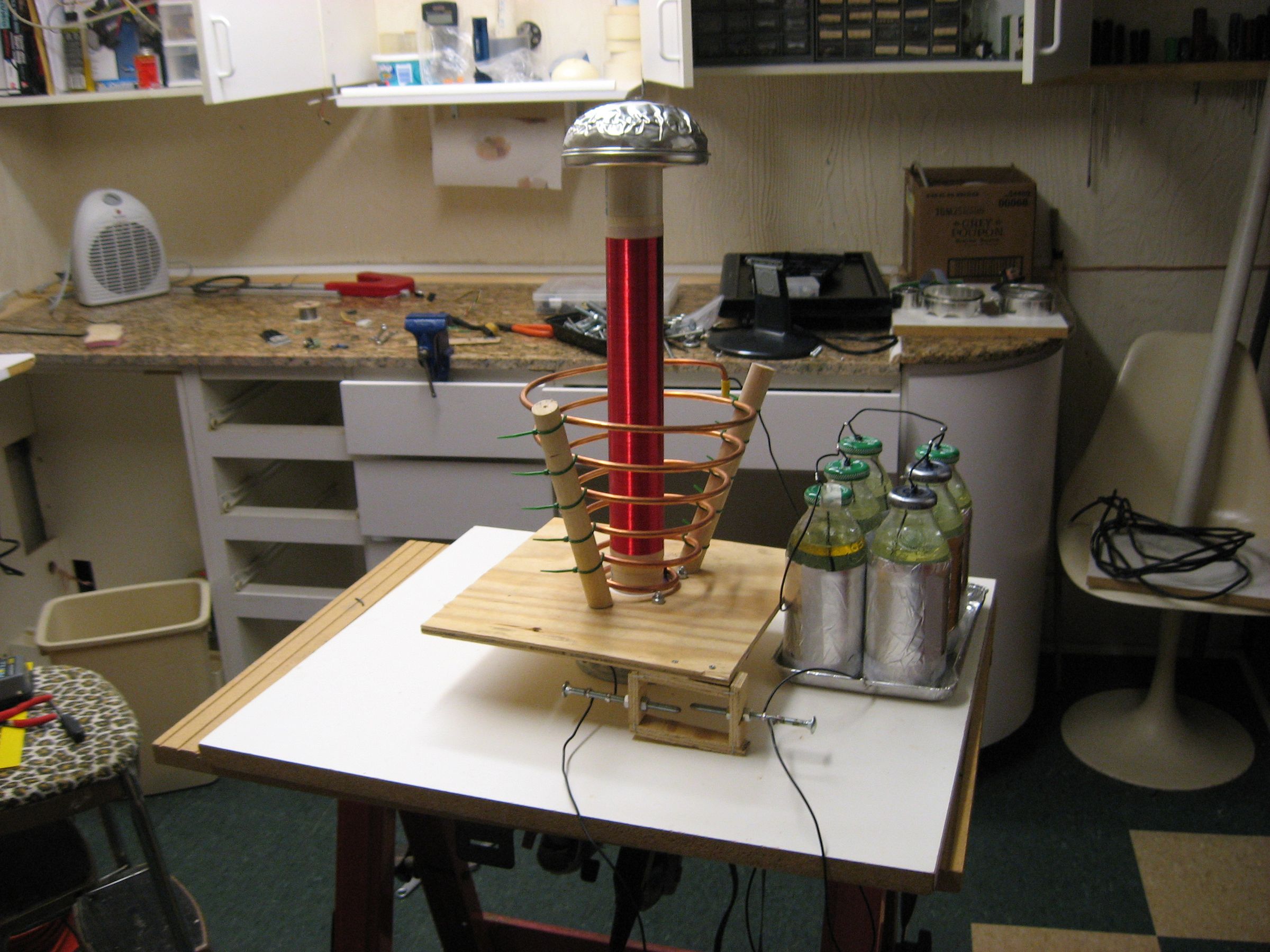

This year I decided to make my garage into a little haunted house. To add some fun and serious scary points, I wrote some code and hooked up one of my Tesla coils to a motion sensor through my Arduino. It now turns on whenever someone walks by, and it's actually very startling.

  • A Tesla coil - $20 - $50

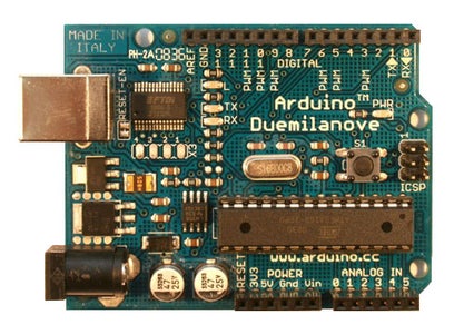

  • An Arduino - $35

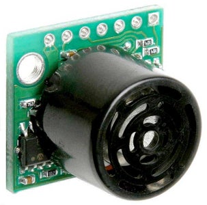

  • A Maxbotix sonar sensor - $25

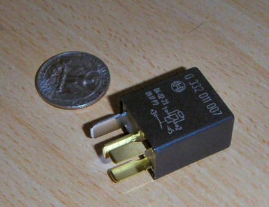

  • One 12V to 120V relay - Free to $6
  • One transistor and a resistor to match the relay - Free from old electronics (See this Instrucable for more info.)

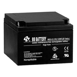

  • 12V Sealed lead acid battery - Don't you have one already?

int transistor = 13;                                 //transistor base to resistor to pin 13unsigned long time = 0;int avgdistance = 0;void setup(){  Serial.begin(9600);                                //protip: plug in a serial lcd for quick testing  sonarSetup();  pinMode(transistor, OUTPUT);  delay(2000);                                       //give time for everything to get ready  for(int i = 0; i <= 30; i++)                       //get an average distance on how far away the other wall is  {    avgdistance += sonarPulseWidth();  }  avgdistance /= 30;  avgdistance -= 50;}void loop(){  int distance = sonarPulseWidth();  Serial.println(distance);  if(distance < avgdistance && (time + 90000) < millis())    //distance has to be less than the avgdistance away                                                             //and can't have been triggered in the past 90 seconds  {    digitalWrite(transistor, HIGH);    delay(500);                                      //turn coil on for 1/2 second    digitalWrite(transistor, LOW);    time = millis();  }}
Also, the code to run the sonar sensor is below.
                         //Sonar GND to ground                         //Sonar +5 to +5                         //Sonar TX -- Useless for this project                         //Sonar RX -- Useless for this project                         //Sonar AN -- Useless for this projectint sonarPW    = 5;      //Sonar PW to digital pin 5, 147uS per inch (2.54cm/in)                         //Sonar BW -- Useless for this projectvoid sonarSetup(){  pinMode(sonarPW, INPUT);}int sonarPulseWidth(){  return ((pulseIn(sonarPW, HIGH) / 147) * 2.54);}

The wiring is fairly simple for the sonar sensor, just connect PW (pulse width) output to Arduino pin 5, +5V to Arduino +5, and GND to Arduino ground. For information on how to hook up the transistor and relay, see this Instrucable by gandalfsz for more info on how to do that.

I was, and still am startled by this thing, and that's while I'm wearing earplugs. Here's me scaring myself silly:
In a few weeks this will go behind a wall of Plexiglas in the soon-to-be haunted house garage.
