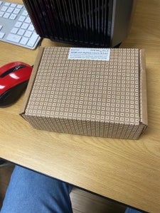

A motion sensor alarm that triggers when something in front of it moves. I created this so I could tell if someone (my parents) entered my room while I am wearing headphones. I don't hear the sound of the door opening when I have them on, but the alarm is loud enough to alert me. I could also tell if someone entered my room when I'm in a different room because the alarm is loud enough to be heard across the house. I chose the box design for 2 reasons. 1: It's convenient, durable, and easy to use. 2: More importantly it blends in with its surroundings. One wouldn't be able to tell at first glance that it's a motion sensor. This wouldn't be the case if it was a 3d printed design.

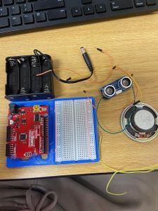

  1. 4 wires
  2. a motion sensor
  3. an Arduino board

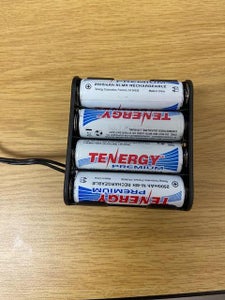

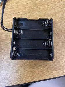

  4. a battery pack
  5. batteries for pack (if necessary)
  6. a speaker
  7. Arduino app
  8. The code
  9. A box
  10. Knife or other sharp tool

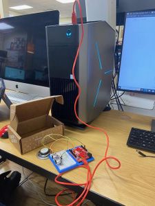

Step 1:
Gather supplies (listed under "Supplies" section)

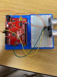

Step 2:

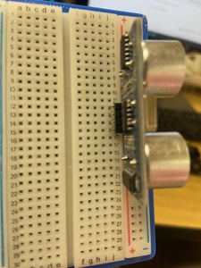

Plug in motion sensor (I did j12-j15)
Step 3:
plug in wires
  • Gnd to Gnd
  • Echo to 7
  • Trig to 8
  • Vcc to 5v
Step 4:

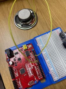

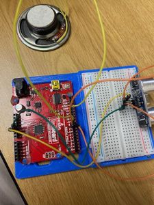

Plug in speaker into 9 and Gnd
Pictures include it by itself and with other wires.

Put batteries in pack if necessary.
Step 6:

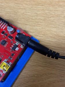

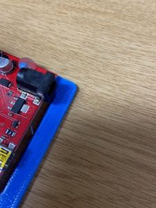

Plug battery pack into Arduino.

Step 8:
Plug in Arduino and send code to it.
(Image shows device being plugged in.)

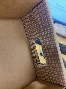

Step 9:

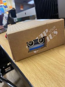

Cut hole in box (in proper location) so motion sensor sense motion.
Step 10:

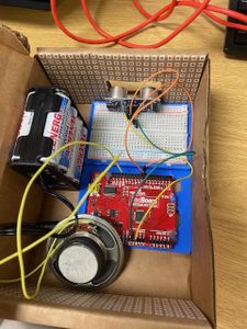

Place device in box. Make sure motion sensor is aligned with the hole.
