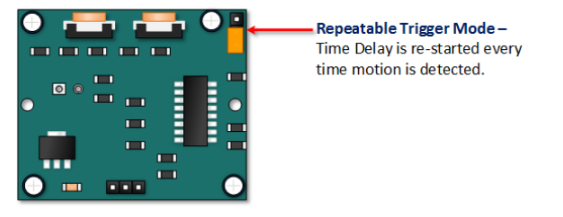

Trigger Mode: The control in the top right corner for the trigger mode. Follow the position of the jumper in the second picture to put your jumper into a repeatable trigger mode. This means that the time delay will be reactivated every time motion is detected.
