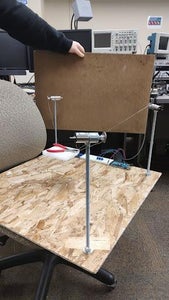

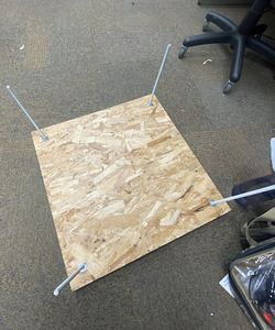

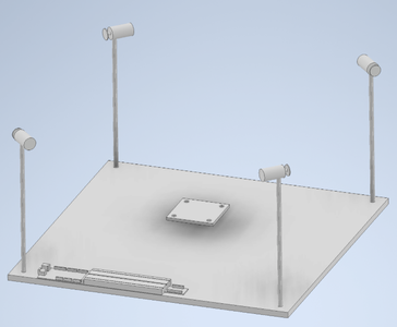

  • First mark each corner of the base board 2 inches from each edge to form a crossing intersection of these lines, this will be your hole center location.
  • Put the ⅜” drill bit into the drill you will be using to drill the hole. (*NOTE* If you are unsure how to tightly fasten the drill bit into the drill chuck ask an adult or consult the internet as this can vary by drill style and brand.)
  • Safely drill each hole such that the marked location is at the center of the hole.
  • Next, attach the 4 lead screw rods. This is done by first putting the washer on the screw then tightening the wing nut onto the screw so that the rod is just slightly extended past the edge of the threaded portion of the wing nut (¾ inch works just fine).
  • Slide the rod with the wing nut through one of the holes with the wing nut on the bottom.
  • Add another washer to the top side of the rod and slide all the way down so that it is on the washer and is laying on the base board. Tighten another wing nut on this same side of the rod until it is tight against the washer, forming a clamp between the 2 washers on either side of the base board. The result should look similar to the first image shown above.
  • Repeat the above steps on all 4 corners of the board until your structure matches the second image shown.

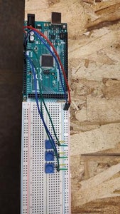

Step 4: Wiring the Breadboard
  • Wire your potentiometer such that the middle pin is connected to the pin labeled "A0" on the Arduino 2560.
  • Connect one of the outside pins to the pin labeled "5V" on the Arduino and the other pin to the pin labeled "GND" for Ground. (*NOTE* It does not matter which outside pin is connected to ground as long as the middle pin is connected to the A0 pin.)
  • Follow this method for the remaining 2 potentiometers changing the middle pin's connection as shown in the first image (one should go to "A1" while another goes to "A2" on the ATMega 2560)
  • Your resulting wiring should match the second image shown above.

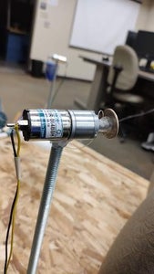

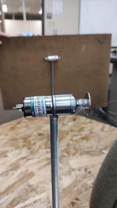

Step 6: Assembling the Motors

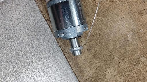

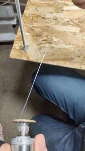

  • Measure out 4 pieces of 40 inch long fishing line.
  • Create a slip knot with one piece of fishing line and feed the extra line through the hole on the motor.
  • Place hot glue over this knot to ensure it will hold.
  • Once the glue dries, go around the whole axle with a thin layer of glue. This is shown in the first image above.
  • Put a small dot of glue on a quarter and press the tip of the motor into it. Ensure there is a strong bond and repeat if necessary. (This will create a spool on the motor and is shown in the second image.
  • Wrap the rest of the fishing line around the shaft of the motor behind the quarter.

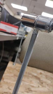

  • Hot glue the top of a rod and press the motor onto the top of it ensuring the end with quarter is facing as shown in the images above. (*NOTE* To ensure the motor holds, hot glue a ring around the bottom to ensure the motor is properly in place.) Repeat these steps for all 4 motors.
  • Glue the breadboard, Arduino, and motor driver to the board.

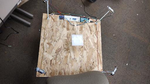

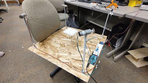

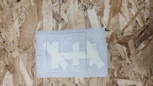

Step 7: Assembling the Platform

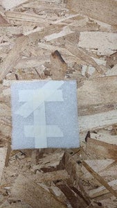

  • Tape together the styrofoam that came in the packaging with the motors as shown in the first image.
  • Cut a square 4inches by 4 inches. This will be your platform.
  • Make four holes in the styrofoam. One in each corner.
  • Loop the fishing from one of the motors through one of the holes in the platform.
  • Double knot the fishing line and hot glue the knots. Repeat this step for all four corners.
  • The system should match the last image above when fully constructed.
