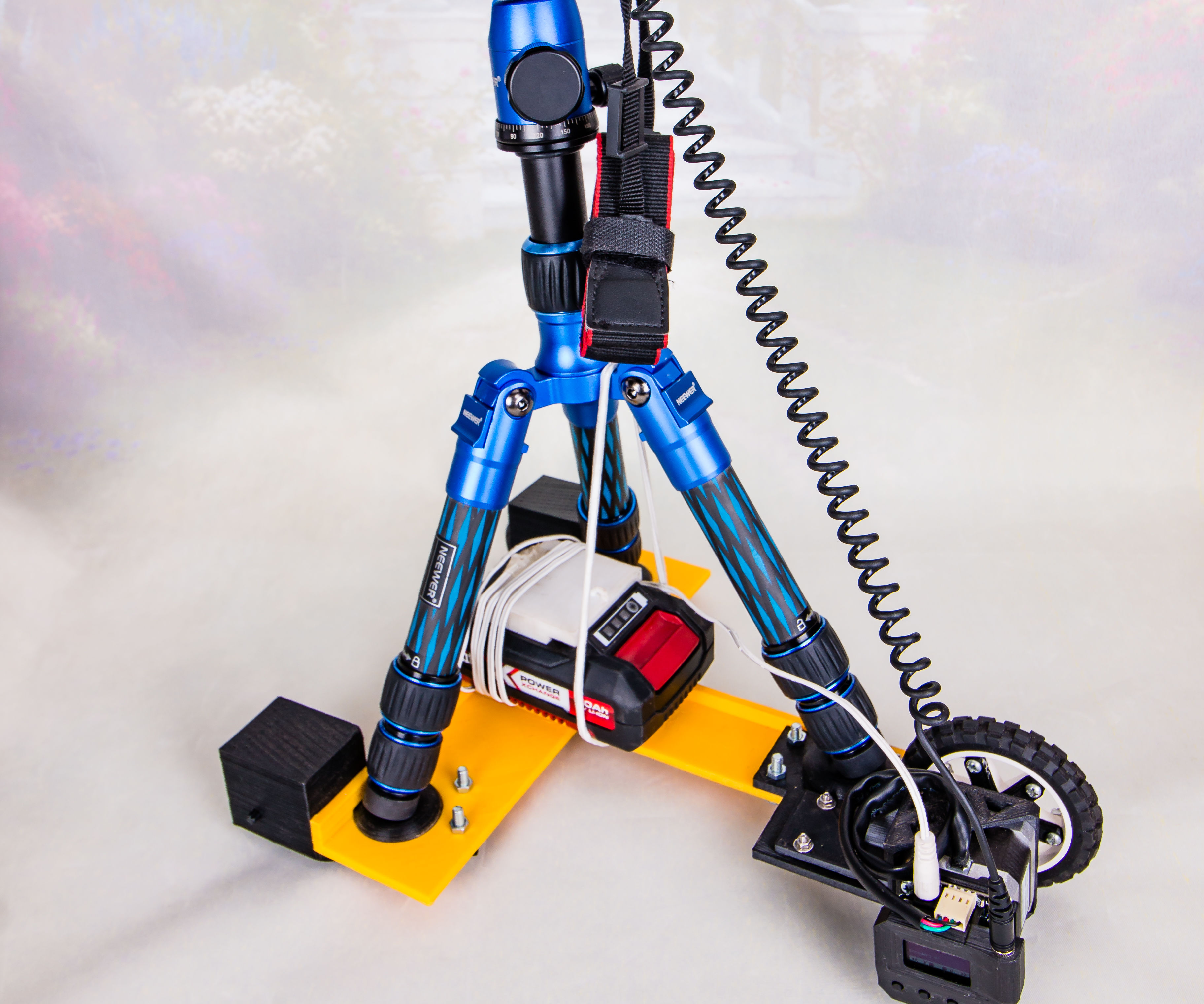

as an instructable there is not much to tell you... 3D print the parts from the included files and add two motors to the pan tilt head, add the NMX controller and away you go.
you will need two nema 17 stepper motors with 19.2:1 gear boxes for increased holding torque and precision. I shortened the supplied leads to make the project neater.
