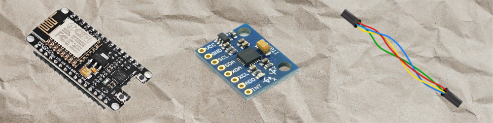

For this project, we will need a NodeMCU (esp8266), an MPU board(6050 but you can use others), and a set of 4 cables to make the connections.

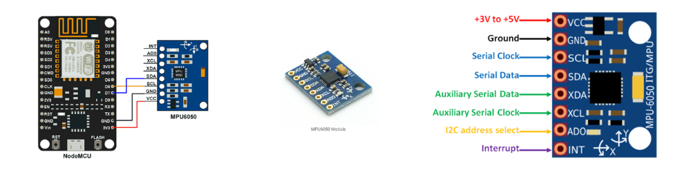

Step 3: Connections
As you can see the wiring between the NodeMCU and the MPU is very simple, ground to ground, VCC to VCC, D7 to SDA(Serial Data), and D6 to SCL(Serial Clock)

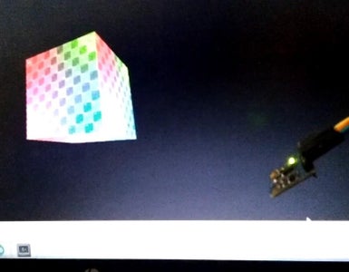

In the js folder, you have the Three library minimized, you will find a link in the description to dive deep into it. In textures, you will find a couple of files that basically will define the appearance of the 3d object. Index has a simple redirect to the main HTML file gyroto3dobject.html, this file contains the scripts required, the Three library, jQuery, and the initialization functions. You will see that has some code to move the object with the mouse that is disabled, you can enable it if you want to play around by uncommenting those lines. Finally, the WebSocket will connect to the localhost with a main function that will process the incoming information containing the position of the object.

As you can see in the final demo of the YouTube video, I have been working on an improved prototype, wireless, and assembled as one unified compact board. Also will try to enhance the capture of the movement by using a fifth-pin INT(interrupt).
