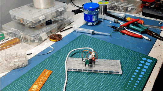

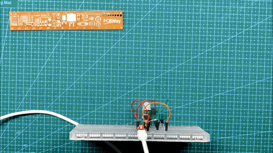

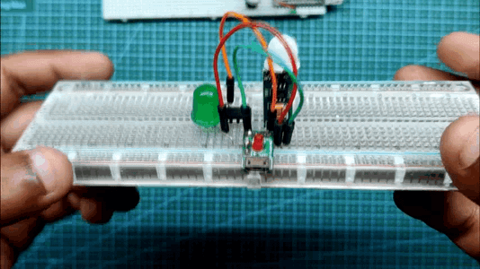

Step 3: First Setup- Basic One
To Prepare the first Setup, we provide VCC and GND of this module with 5V.
We add an LED's VCC Pin on the signal Pin of this module and connect the GND of the LED with the GND of the Module.
This will be the first and most basic Setup we can prepare with this module.
Just by standing near this sensor, It turns ON the LED, LED will stay ON for 8 seconds and then turn OFF, if we are near the 3M Radius of this module, the LED will turn ON again.

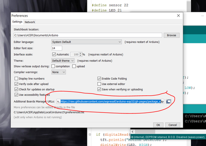

Step 5: Preparing TTGO Board for Arduino IDE
We first have to install board files for ESP32 by putting this link in the preferences of the Arduino IDE Settings and then installing the boards through the board manager.
https://dl.espressif.com/dl/package_esp32_index.json

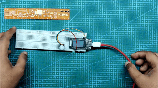

Step 7: Connections - Wiring
next, we connect everything by following the attached wiring diagram image.
  • VCC of PIR to 5V of TTGO
  • GND to GND
  • Signal Pin of PIR to D22
  • LED's VCC to D21
  • LED GND to GND

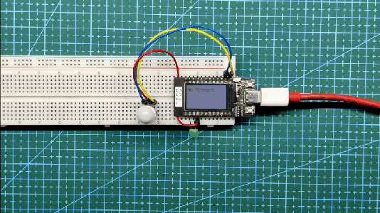

It uses TFT_eSPI Library to display a message on the onboard RGB Display as soon as the board receives the signal from PIR Module, also the board triggers an LED depending on the signal received.
Step 9: Working
We supply board 5V through the USB Cable and the setup will start functioning as it should. When we move in front of the module within a radius of 3M, PIR detects the movement and sends a signal to the TTGO Board that displays a message of signal detection and also turns ON the LED connected on D21.

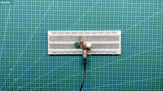

Step 10: Attiny85 Standalone Setup
Here's another setup that is similar in working with the TTGO Version but uses a single Attiny85 MCU that significantly reduces the number of components.
Attiny85 is an AVR MCU that has 8 KB ISP Flash memory, 512B EEPROM, and 512B SRAM which is enough for driving a load with PIR Sensor as its sketch is small in size so it would be an overkill to use an ESP32 Device in this project.

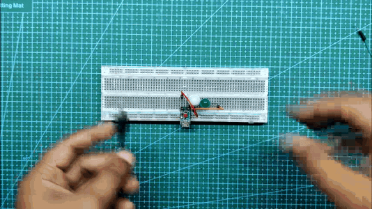

The sensor is connected with the D0 pin and the LED is connected with the D1 Pin.
When the Sensor picks any motion, it sends a signal to D0 and MCU triggers D1 Pin that turns ON the LED.
Step 13: Result
Here's the result of the Attiny85 Setup.
Pros of using this setup are its size and form factor, it can be easily used in a custom board and it's minimal, we don't need any other components to properly run it which is a plus point of using this small MCU in a lighting-related project that I'm already working on.

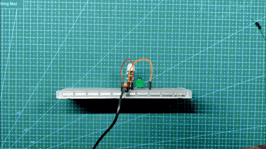

Step 14: Without Microcontroller With Transistor
Here's the third setup that is similar to the first one, the only difference here is an additional NPN Transistor that drives a load by changing the state of the transistor's base through the PIR Signal Pin.
Step 15: Connection- Wiring
We connect an NPN transistor with the PIR setup by connecting a load with it through the collector and connecting its base with the signal pin of the PIR Module.
Here, the BC547 Transistor is Setup in the "transistor as switch" configuration that is commonly used to turn ON-OFF XYZ stuff like LEDs, Relays, etc.
Step 16: RESULT
Here's the result, the setup is working and the loads are working properly.
