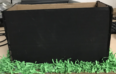

Step 1: Build the Model House
Steps:
  1. Design the Base:
  2. Cut a square piece of cardboard to serve as the foundation for the house.
  3. It can be any size but ensure there is enough space for all of the components to fit inside.
  4. This base will support the walls and hold the electronics.
  5. Construct the Walls:
  6. Cut 4 rectangular pieces for the walls.
  7. Assemble the House:
  8. Glue the walls to the base and to each other using a hot glue gun. Ensure the walls are perpendicular to the base.
  9. Leave the roof open or make one side of the structure removable for easy access to the electronics.
  10. Decorate:
  11. Paint the house or use decorative paper to create a realistic appearance.
  12. Add any labels or decorations to make it your own!

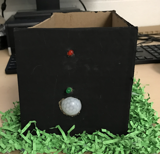

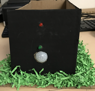

Step 2: Set Up the Electronics
Component Placement:
  1. PIR Sensor:
  2. Attach the sensor on one of the walls ensuring it faces outward for maximum motion detection.
  3. Use double-sided tape or glue to secure it.
  4. Green LED:
  5. Cut a slit to insert the LED, and secure it in place.
  6. Red LED:
  7. Place near the top or above the PIR sensor to represent "Alarm Triggered."
  8. Secure it using the same method as the green LED.
  9. Buzzer:
  10. Mount inside the house where sound can escape.

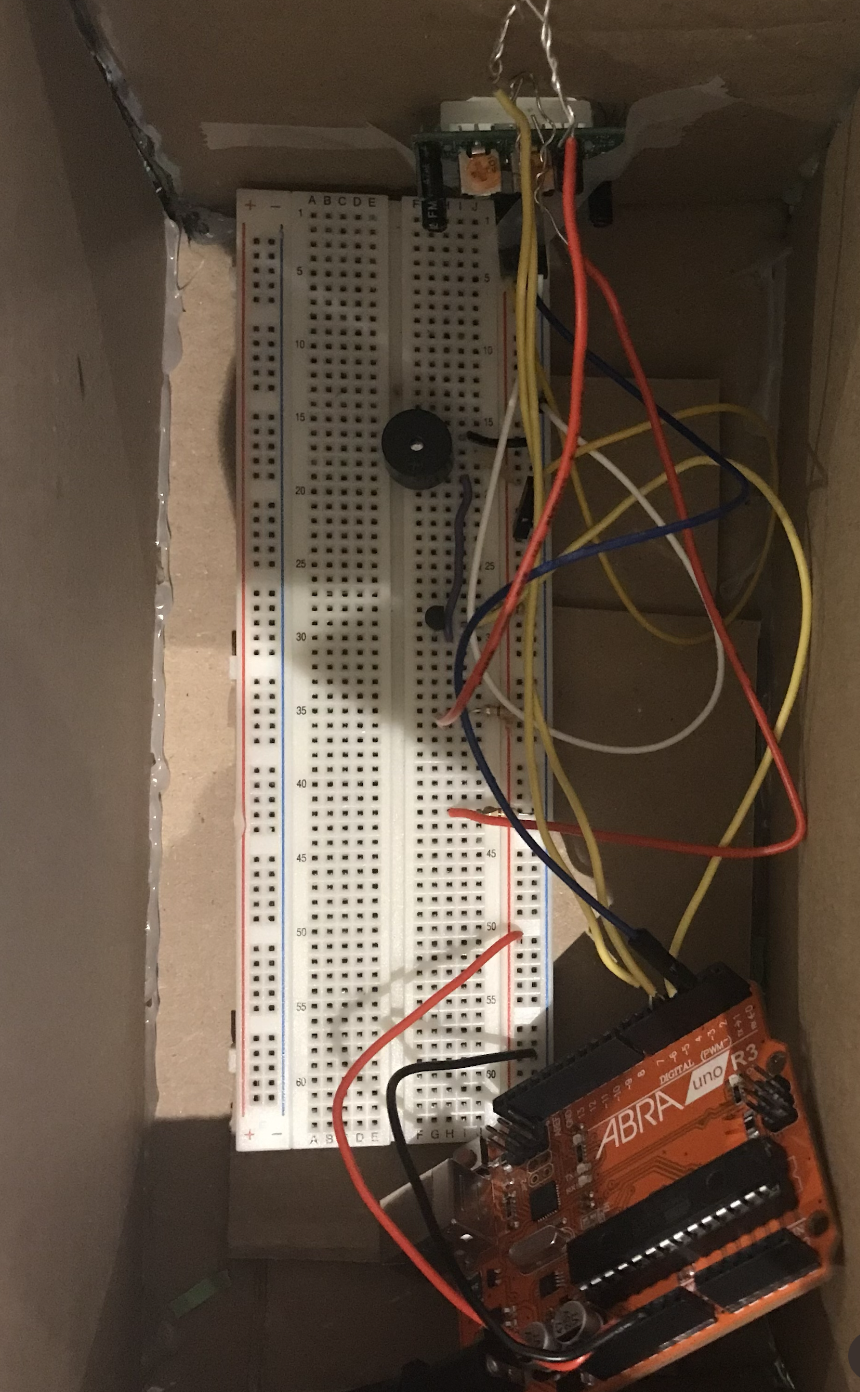

Step 3: Wiring the Components
Connections:
  1. PIR Sensor:
  2. VCC pin to Arduino 5V.
  3. GND pin to Arduino GND.
  4. OUT pin to Arduino Pin 2.
  5. Green LED:
  6. Anode (+) to Arduino Pin 5
  7. Cathode (-) to Arduino GND via a 330-ohm resistor.
  8. Red LED:
  9. Anode (+) to Arduino Pin 4.
  10. Cathode (-) to Arduino GND via a 330-ohm resistor.
  11. Piezo Buzzer:
  12. Positive terminal to collector of NPN Transistor.
  13. Negative terminal to Arduino PWR.
  14. NPN Transistor:
  15. Collector connected to the positive terminal of the piezo buzzer.
  16. Base connected to Arduino Pin 3.
  17. Emitter connected to GND via a 10k resistor.

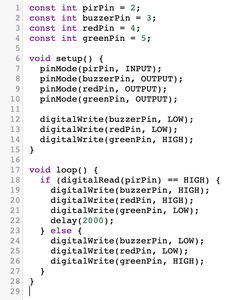

Step 4: Write and Upload the Code
const int pirPin = 2; // PIR motion sensor
const int buzzerPin = 3; // Buzzer
const int greenPin= 5; // Green LED
const int redPin = 4; // Red LED
Why this is done:
  1. We define constants to represent the pins to which each component is connected on the Arduino board. This allows for easier maintenance of the code, as pin assignments are centralized at the beginning.
  2. pirPin is for the motion sensor, connected to digital pin 2.
  3. buzzerPin is connected to pin 3, which will produce the alarm sound.
  4. greenPin is connected to pin 5 to indicate the system is in safe mode.
  5. redPin is connected to pin 6 to indicate an alarm when motion is detected.
void setup() {
pinMode(pirPin, INPUT);
pinMode(buzzerPin, OUTPUT);
pinMode(greenPin, OUTPUT);
pinMode(redPin, OUTPUT);
Serial.begin(9600); // Initialize Serial Monitor
Why this is done:
  1. The setup() function is called once when the Arduino is powered on or reset. It configures the input and output pins.
  2. pinMode(pirPin, INPUT); sets the PIR sensor pin to input, as the sensor will send signals to the Arduino when it detects motion.
  3. pinMode(buzzerPin OUTPUT); sets the buzzer pin as output, since we want to control the buzzer.
  4. The green and red LEDs are set as outputs because we will use them to indicate system status.
  5. Serial.begin(9600); initializes the serial communication so we can send status messages to the Serial Monitor.
digitalWrite(greenPin, HIGH);
digitalWrite(redPin, LOW);
digitalWrite(buzzerPin, LOW);
Serial.println("System Armed. Green LED is on.");
Why this is done:
  1. This block sets the initial state when the system starts:
  2. Green LED is turned on (HIGH), indicating that the system is armed and in safe mode.
  3. Red LED is turned off (LOW), as no alarm has been triggered yet.
  4. Buzzer is turned off (LOW) to avoid any noise.
  5. A message is sent to the Serial Monitor to confirm that the system is in the "armed" state.
void loop() {
if (digitalRead(pirPin) == HIGH) {
Why this is done:
  1. loop() is where the continuous checks and operations happen. The Arduino will repeatedly check for any changes in the PIR sensor and update the system's status accordingly.
  2. int motion = digitalRead(PIR_PIN); reads the state of the PIR sensor (whether it detects motion or not).
  3. HIGH indicates motion is detected.
  4. LOW means no motion.
// Motion detected
digitalWrite(greenPin, LOW); // Turn off green LED
digitalWrite(redPin, HIGH); // Turn on red LED
digitalWrite(buzzerPin, HIGH); // Activate buzzer
Serial.println("Motion Detected! Red LED on. Alarm Triggered.");
delay(2000); // Alarm duration
} else {
// No motion
digitalWrite(greenPin, HIGH); // Turn on green LED
digitalWrite(redPin, LOW); // Turn off red LED
digitalWrite(buzzerPin, LOW); // Turn off buzzer
Serial.println("No Motion. System Armed. Green LED on.");
delay(500); // Stabilize sensor
Why this is done:
  1. The if-else block checks if motion is detected:
  2. If motion is detected (motion == HIGH):
  3. The green LED is turned off, signaling that the system is no longer in safe mode.
  4. The red LED is turned on to indicate an alarm has been triggered.
  5. The buzzer is activated to produce an alarm sound.
  6. A message is sent to the Serial Monitor to log the event.
  7. delay(2000) causes a 2-second pause, allowing the red LED and buzzer to stay on for 2 seconds before resetting.
  8. If no motion is detected:
  9. The green LED remains on, showing the system is in a safe, armed state.
  10. The red LED and buzzer are turned off to ensure the system is quiet and in standby mode.
  11. A message is sent to the Serial Monitor to confirm the system is armed.
  12. delay(500) stabilizes the sensor, preventing any potential flickering from sensor noise.

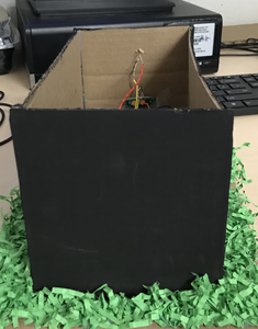

Step 6: Final Assembly
  1. Secure Components:
  2. Ensure all components are firmly attached and wires are organized.
  3. Close the Roof:
  4. Attach the roof or close the removable panel after testing.
  5. Presentation:
  6. Showcase your functional security system in the model house!
