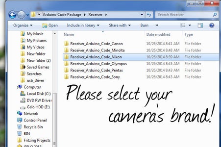

Step 9: Upload the Arduino Codes
Obviously Arduinos need codes to work! :)) They are computers after all. Here are the codes for both the Remote Receiver and the Beacon. The remote receiver's code written in this page is for Nikon users only. Please download the code package below if you're using a different brand. Here are the supported/ compatible brands Canon, Minolta, Nikon, Olympus, Pentax, Sony. As for the beacon's code, compatibility is not an issue.

Remote Receiver (RX - Nikon):
#include
#include
Nikon D5000(11); // I Use Nikon (please use the code that works with your DSLR)
