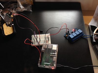

Tired with stumbling on stuff in my garage that doesn't have a light switch I decided to do something about it. Motion sensor connected to a light was the result and it works really well.

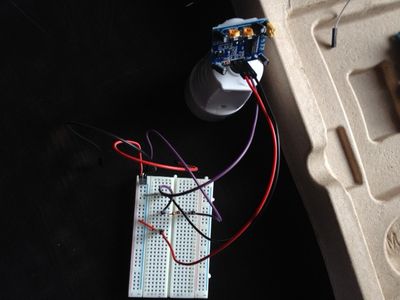

Step 1: Motion Sensor to Breadboard
Red cable is for power (5v), black for ground and purple is for output.
Between the output and the cable going to the RPI GPIO there is a 10k resistor.

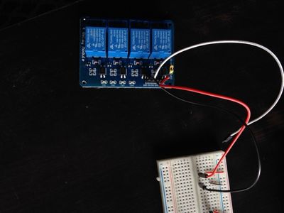

Step 2: Relay to Breadboard
Here is how I connected the relay to my breadboard. Red for power (5v), Black is ground and the White cable to go into the RPI GPIO.

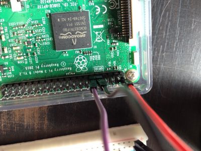

Step 3: Raspberry GPIO Pins Used
Raspberry connections for power (5v) and ground (black) to both motion sensor and relay and input from motion sensor(purple).

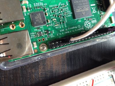

Step 4: Output to Relay From Raspberry GPIO
GPIO pin used for signal to the relay.

Breadboard and the Cayenne interface to trigger it all.
