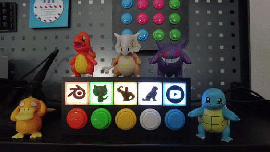

About: Hello, I am Vernon from NerdCave a DIY channel, I focus on microcontrollers and coding.
Do you ever find yourself struggling to stay motivated and on track with your daily tasks? Maybe you start off strong, but as the day goes on, you find yourself getting distracted or losing focus. If so, you're not alone. In this project tutorial, I'm going to show you a fun and effective way to stay motivated and achieve your goals. It's called the Motivational Box, and the goal of it is simple. I have a few tasks I want to complete, the RED LED indicated an uncompleted task, once I completed the task I will press the arcade button it will turn the LED to the corresponding arcade button (or any color of your choosing) and update it on a site where I can track the days I completed my tasks. The graph is inspired by GitHub code contribution heatmap.
Now for you to understand why I created this project I need to tell you a story. The last few months, I was really struggling with my motivation. I had a lot of goals that I wanted to achieve, but I just couldn't seem to get started. I tried all kinds of things - setting reminders on my phone, using sticky notes, even trying to hire a personal coach or telling all my friends and colleagues today is the day I am going to change. But nothing really worked.

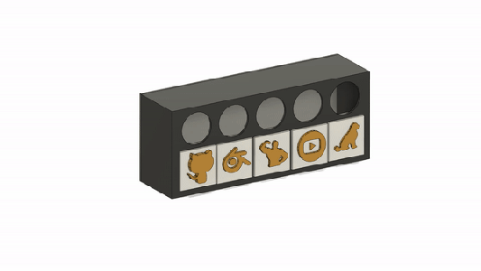

3D printed parts - (Files below)

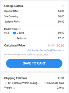

Step 2: PCB ( JLCPCB )
The PCB was ordered through JLCPCB. They offer great PCBs at a low cost and have promotions and coupons available throughout the year. You can sign up using here, or using the following link:
https://jlcpcb.com/?from=NerdCave that will support me as a creator to keep making content that is accesseble and open source at no charge to you.
Ordering the PCB is very simple:
Download the Gerber using the link: https://github.com/Guitarman9119/Raspberry-Pi-Pico-/blob/main/Motivational%20Box/Motivational%20Box%20Gerber.zip
Sign up throughhttps://jlcpcb.com/?from=NerdCave
  • Click on Add gerber file
  • Leave all the settings as default given. You might want change the PCB color.
  • Finally save to cart, enter your shipping details and order the PCB

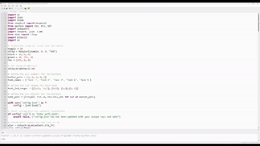

Step 3: Code
MicroPython
To following along with this tutorial make sure you have all the following files as indicated. You can download it from my GitHub repository. Here a short in depth overview of the main python script with code snippets explained.
Github Link: https://github.com/Guitarman9119/Raspberry-Pi-Pico-/tree/main/Motivational%20Box/Code%20-%20Pico
# Import necessary libraries and modules

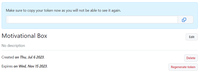

before creating the token from github let's first look at the website and hosting

Step 6: How to Create Github Token
Log in to Your GitHub Account: Make sure you're logged in to your GitHub account.
Access Personal Access Tokens Settings:
  • Click on your profile picture in the upper-right corner.
  • Choose "Settings" from the dropdown menu.
  • In the left sidebar, select "Developer settings", then click on "Personal access tokens".
Generate a New Token:
  • Click on the "Fine-grained tokens" button.
  • Click on generate new token
  • You might be prompted to enter your GitHub password to proceed.
Configure Token Settings:
  • Enter a meaningful name for your token to help you remember its purpose.
  • Choose the desired expiration for the token. You can choose between no expiration, a set expiration, or a custom expiration.
Select Scopes:
  1. GitHub provides a range of scopes that determine the level of access your token will have. You can grant access to specific repositories, organizations, and services. Be cautious and only select the scopes that are necessary for your intended use.
  2. Repository access: Select the repository where you will have your website.
  3. Generate Token: Once you've selected the appropriate scopes, click the "Generate token" button at the bottom of the page.
  4. Copy and Store the Token: After generating the token, GitHub will display the token value on the screen. This is the only time you'll see the token, so be sure to copy it and store it securely. Treat this token like a password, as it grants access to your account.
  5. Use the Token: You can now use the generated token in your applications, scripts, or any other place where you need to authenticate with GitHub. When making API requests, include the token in the headers (Authorization header) as a bearer token. Use this token in code above.
Remember to keep your tokens secure and never share them publicly. If you believe a token has been compromised, you can regenerate or delete it from the GitHub settings.
Step 7: Motivational Box Design
The box was designed in Fustion 360. It is important that you use white filament for task indicator to allow the LED to diffuse through the white filament to indicate the task status.
You can download all the 3D files here: https://github.com/Guitarman9119/Raspberry-Pi-Pico-/tree/main/Motivational%20Box/3D%20STL%20Files
