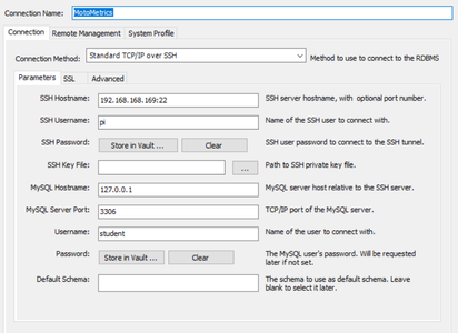

On the Pi
Download, install and launch MySQL Workbench
Click on the "New Connection" button in the "MySQL Connections" section of the home screen.
Use the details in the image above
Open the .sql file inside the "database" folder of the repository and run it with MySQL Workbench to install the database on the Pi

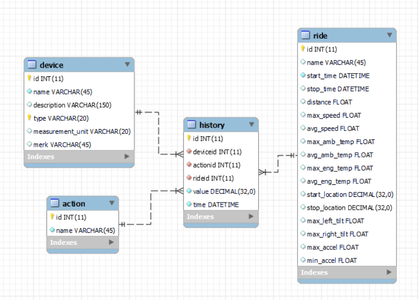

The database
  • Ride
Stores all the rides you make, when a ride is started only the id, name and start_time are stored. when the ride ends the backend gets all the values of the history table that corresponds to the ride and calculates the minimums, maximums and averages to then update the ride with all the information. The start_time defaults to "CURRENT_TIMESTAMP"
  • history
Here is where the largest amount of data is stored. When a ride is started the backend sends every 5 seconds the captured data to the database. this data is later used to calculate maximums, minimums, averaged, distance and plot the route taken. This table is the only one with Foreign Keys: rideid, actionid, deviceid
  • action
This table is to give more explanation to things that happen in the history table like "save speed"
  • device
To know out of what sensor the value is from, we need to keep track of our devices. this is simply a list with all our components

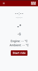

Step 5: Frontend
On the Pi
Apache2 is already installed on the Pi image but it wil now only show the contents of "/var/www/html" so eather you move the contents of the "front" folder inside the repositroy with "sudo cp -r <path to repository>/front/. /var/www/html"
or
you change the settings of apache by using "sudo nano /etc/apache2/sites-available/000-default.conf" and change whatever is after "DocumentRoot" to <path to repository>/front. after that you just need to use sudo nano "/etc/apache2/apache2.conf"and change
<Directory />
    Options FollowSymLinks
    AllowOverride All
    Require all denied
</Directory>
to
<Directory />
    Options Indexes FollowSymLinks Includes ExecCGI
    AllowOverride All
    Require all granted
</Directory>
After a reboot you schould see the MotoMetrics site when u surf to the Pi's ip
The Frontend
  • .html
The diferent pages of the site that you surf to with your browser
  • style
The files used to style the pages. i used SCSS compiler so i could make use of a boilerplate and open-color
  • scripts
the javascript's needed to display data from the backend and provide extra features. The datahandler.js is needed to get data from the backend trough routes. aigain, app.js is the headliner here
  • maps
Because i won't always have an internet connection with my pi i wont be able to use api's. So i downloaded maps for the local area instead (this is also why i need to download the script's for socket.io and leaflet)

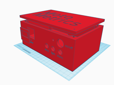

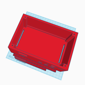

Step 7: Housing
I have designed a project box measuring 18cm x 12cm x 7cm to accommodate all the components. The box features specific holes for a power lead, status LED, power button, and three female 2.1mm barrel plugs, allowing the sensor and actuator to be "Hot pluggable." In the top view of the blueprint, you can observe two slits intended for attaching velcro or a tension strap. These slits are then covered with the floor of the box, enabling the electronics to be mounted while allowing the strap to be adjusted. The O-led display is affixed to the outer screen plate, which is subsequently glued to the box.
After printing the housing (and making necessary dremel adjustments), I installed all the surface-mount buttons and connectors. To enhance the watertightness of the project, I added rubber rings wherever possible.
