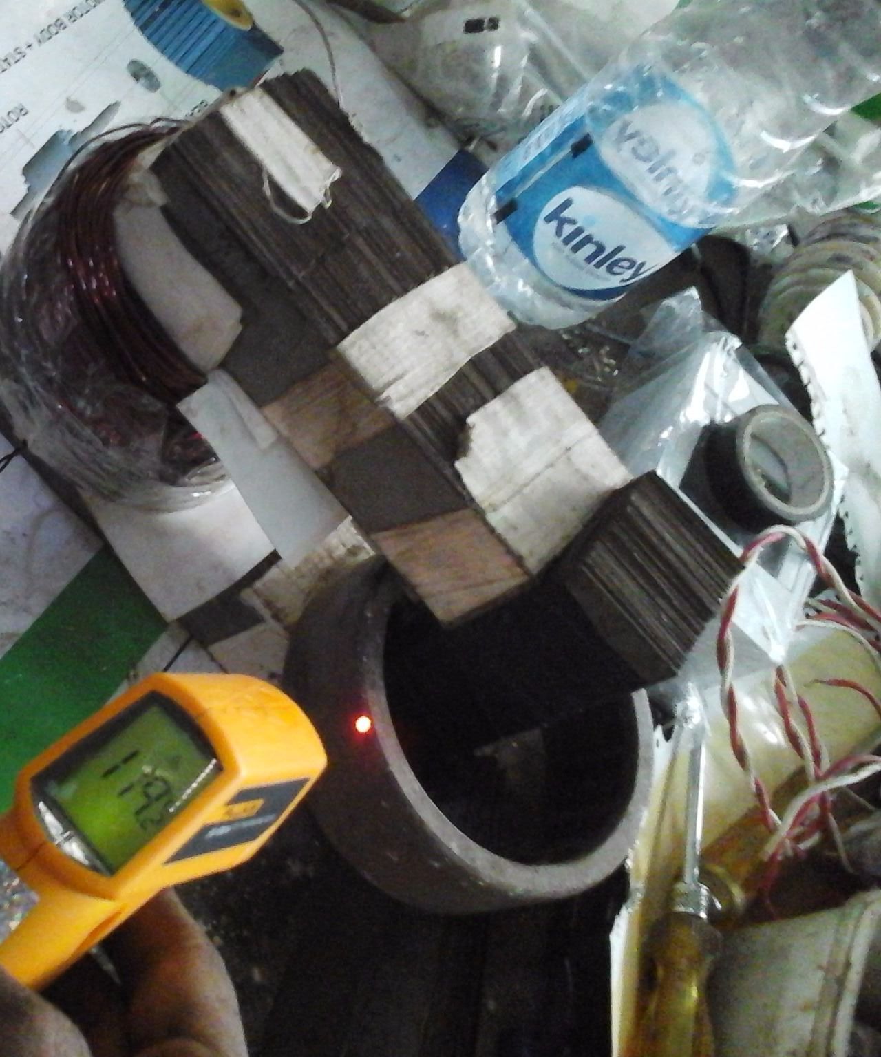

3d printed pla print in ender3 at 4.5 hr Motor coill inserting machine / tool, for kirlosker 3ph ,1.1 kw 1480 rpm motor 24 slot , tool cost Rs. 2000 only. its save time for rewinding of motor , no need to big coil inserting machine.
Step 1: Fix Coil in the Tool
fix coil in the tool carefully, copper wire layer not mix.
Step 2: Push Coil in to Stater Slots
push tool in to stater slots with coil using tool guide.
