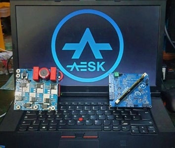

Step 1: Motor Control Unit
Motor control unit; provides most efficient vehicles by controlling motor the best way. It consists of control and power card. Control and power card are connected each other with headers. All this boards are produced by JLCPCB.
Step 2: Control Card
In the control card section, information from hall sensors, encoder, temperature sensor, voltage and current sensors is received. The control card provides communication with other units with the CAN communication protocol. Switching signals are generated, thereby enabling the MOSFETs to switch. Thanks to the microprocessor in the control card, the control algorithm is processed.

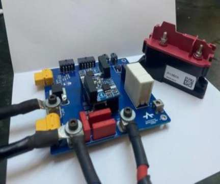

Step 3: Power Card
In the power board section, the battery voltage is processed and sent to the motor. It is supplied with DC voltage from the battery, converts this voltage to AC and supplies the PMSM motor. Thanks to the current sensors in the A and B phases, the current values are read and sent to the control card. Thanks to MOSFETs, the appropriate PWM is created according to the signals sent by the control card by making switching. There are 3 gate drivers to be able to switch MOSFETs, these gate drivers are connected to MOSFETs with headers. The capacitors provide instantaneous power to start the motor.
