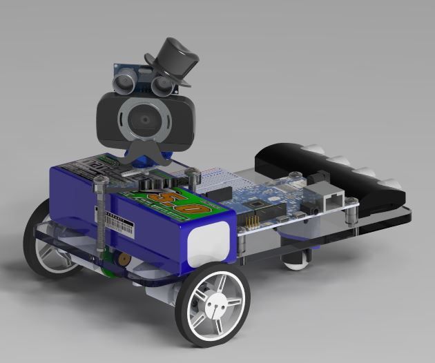

We have been using the MakeyMakey boards at the Children's Museum of Houston to teach kids the basic concepts behind circuits and micro-controllers. If you browse the MakeyMakey website, you will see how it can be used to easily convert any slightly conductive material into a keyboard button. This makes it great for physically interacting with computer programs. But what if you want to use the MakeyMakey interact with something more physical like a robot? This instructable will show you how.
