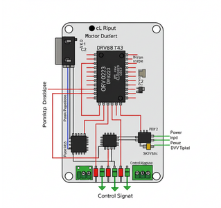

Step 3: Block Diagram
Power Input:
  1. VIN: 12V to 36V input
  2. GND: Common ground
  3. Capacitors:
  4. 100nF + 10µF (ceramic) near VIN pin
  5. 470µF electrolytic near input connector
DRV8243 Pins:
DRV8243 Pins:
  1. IN1 / IN2 or PH / EN: Motor control (from MCU or logic pins)
  2. nSLEEP: Tie HIGH for operation or control via MCU
  3. nFAULT: Open-drain fault output (connect to MCU or LED)
  4. MODE: Tie LOW for IN/IN or HIGH for PH/EN
  5. IPROPI: Optional current sense output
  6. OUT1/OUT2: Connect to motor terminals
Step 4: Schematic Diagram
Schematic Diagram of DRV8243
