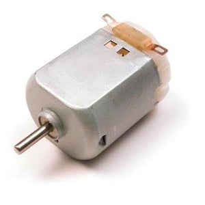

  • A small power rating DC Motor.
  • Some breadboard jumper cables.
Note : This project only works for standard 1.5V to 3V Tamiya DC Motor. Any higher power rating DC Motor will not move because 555 Timer IC has limited output power.

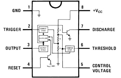

If you are not familiar with 555 Timer IC, here is the schematic of its internal components and pinouts.
Put two 555 Timer ICs (pin 1 on bottom left) in the middle of breadboard with a little space in between because we will plug many jumper wires here. I already have my mini switch on top left. At bottom left you see black spot, just ignore it. It was burnt on testing, so I mark it black :P And you see on the right side I have link the top and bottom VCC rails and Ground rails.
