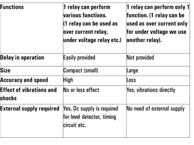

Step 1: Step1 :basic of Motor Management System for Hoisting Application Using Arduino Mega 2560 and IoT
