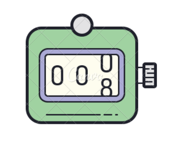

Step 4: COUNTER
In this part of the code, it has the function to count up or count down the value of binary that is sent passing through this part. We make it this way because we want to make a counting timing device that will activate according to the limit of count that is determined from the user input. The upper limit of the count is user programmable and the counter’s increment value can be user-defined. The signal is then sent to the Shift Register. In the code that we have to build, we use an internal signal for the value of the count named count_in, we also have count_up and count_dwn to increase or increase the value of the counting by 1 so we can make the counter count up or count down depending on the circumstance that we need it. We also made a reset setting to reset the value of the count_in just in case we need to reset the system.
To find out more about this, you can click here >> HERE

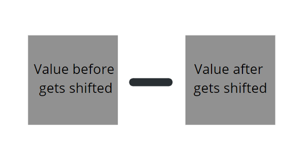

Step 6: SUBSTRACTOR
We need a subtractor in this code to determine the feedback of the motor so it could be sent and processed by error management code. The subtractor can be adjusted according to the amount of the shift registers needed to shift the state value. Therefore, the right feedback calculation can be done.
To find out more about this, you can click here >>HERE
