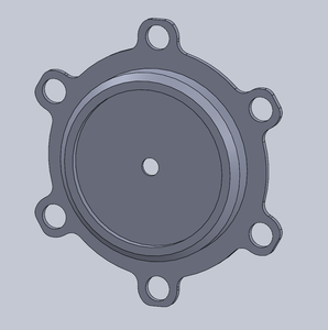

A couple years later, while I still liked the overall look of the clock, the warmth and look of the wooden piece in the middle didn't really match the industrial look I was going for. With access to a 3D printer I redesigned the clock mount and printed if out of white filament with a black acrylic insert.
While being at it I also added some 3D printed numbers to the clock which where simply superglued to the sprocket.
