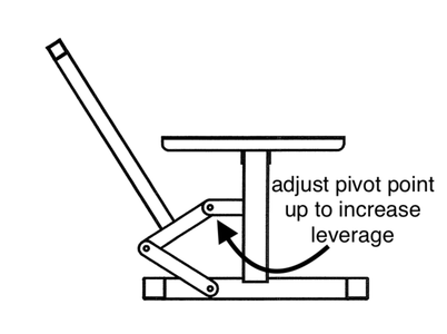

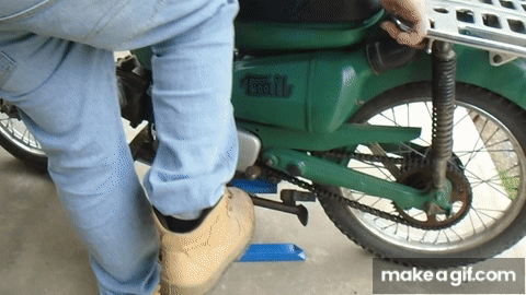

Step 1: Using the Stand
Before you start, you need to understand that the stand is designed to lift your bike about 2 inches so you can remove the wheel or do other work. A mistake my students often make is trying to lift the bike a foot off the ground with the stand, which makes it nearly impossible to use. The problem is that the stand is limited to the force you can put on the lever that you stomp on. The higher you lift the bike, the more force you have to push on the lever.
You can adjust the amount of travel the stand will move by choosing where you weld the top pivot on the centre outer post. The higher the pivot, the more weight you will be able to lift and the less height the stand will travel.

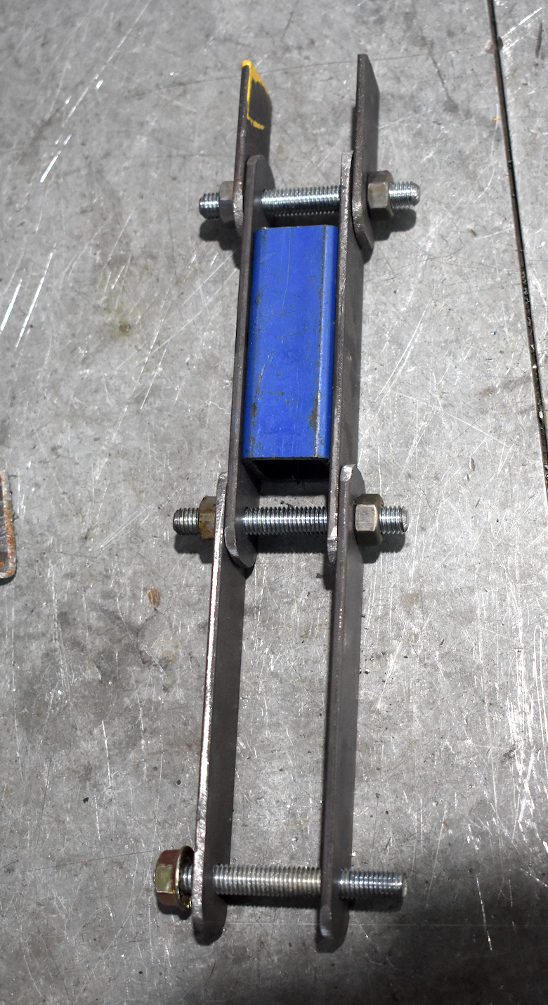

Step 5: Preparing the Mechanism
Assemble the links on the bench with a scrap piece of 25mm square for a spacer. You will need to use some flat washers to space the links correctly and keep the links parallel. Set up the links as shown in the photos and tack it together in the fully down position. Tack the handle in, also in the down position, with a spacer to keep it in contact with the ground. Make sure the mechanism works correctly and does not bind before welding.
You will notice in the photo that the centre inner post is sticking out when in the down position. This is because the stand was checked against the height of the bike and found to be too tall. This was easily corrected as it was only tack-welded together, and the stand could be shortened easily.
Do not weld until you have checked that everything works and fits correctly.
