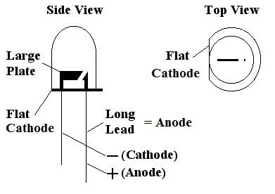

Step 2: Wire Four White LEDs in Series
Wire the four LEDs in series as shown in the circuit. The LED anode(+) and cathode(-) can be recognized by the flat side of the plastic lens or by the lead length as shown in the diagram. My application was for licence plate illumination so I wired the LEDs in a straight line and oriented them in the direction that I needed the light. Unlike incandescent bulbs, LEDs are a directional light source so arrange your LEDs appropriate for your application.
