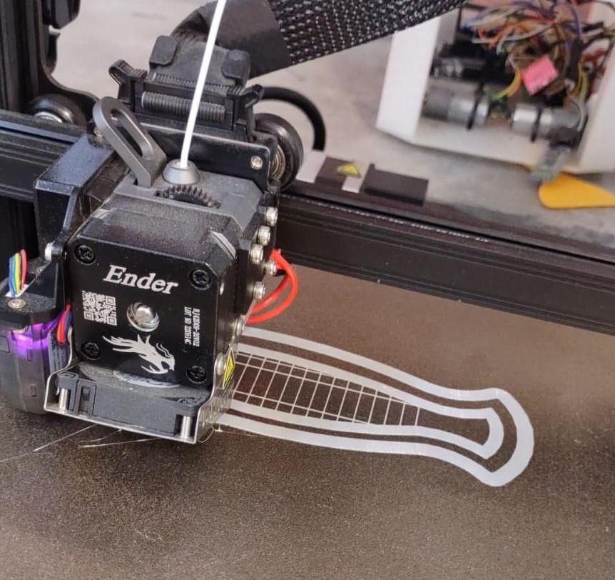

Step 1: Pieces
The robot will emulate the inferior part of the human body, so it's pieces are to be understood as the hip, the legs and the feet (all parts included below).
The whole robot is aproximately 20 cm in height accouting for the servomotors size and the space used between pieces.
All files are to be cut once, except for the one titled columns.dxf that one has to be cut three times.
NOTE: The software used to model the pieces was CATIA, but the platform Instructables does not support the extension (.CATPart), so the (.dxf) files were uploaded (these extensions is the one you'll use to cut the MDF), nevertheless a link with the (.CATPart) files is included (CATPart). Photos are available so you know how they'll look once put together.
