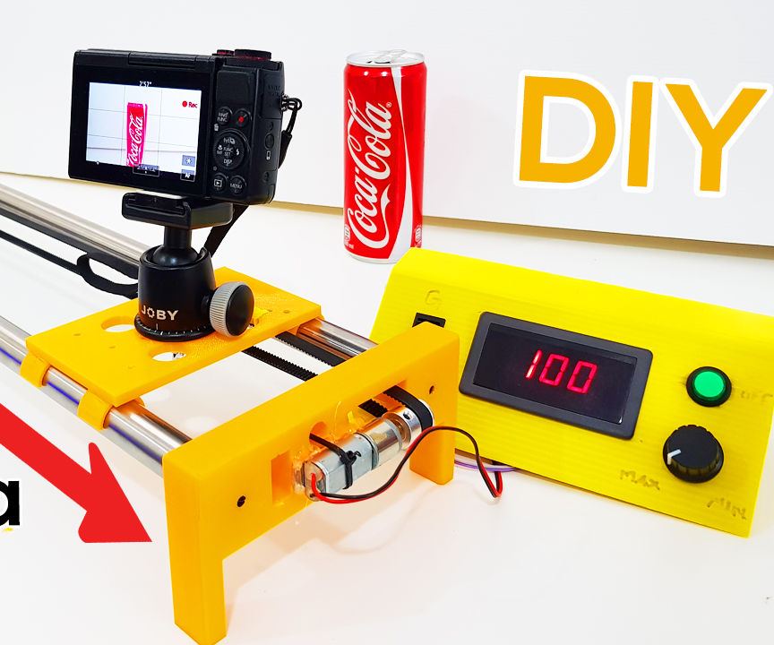

In this project all I had to do was to somehow attach the High Geared motor to the rotating platform (SNUDDA).
For this I used a few Popsicle sticks and hot glue to build a base on which Motor was mounted.
At the end of motor shaft I attached HOT GLUE by cutting a small section from the GLUE STICK, this would provide grip to motor while rotating the platform.
Powering
This motor is rated at 12v. It is high geared so the speed is slow. But I made it to run on USB power which is 5 volts to make it much more slower. As for video, I can speed up in the FCPX or AE, so that's not a problem.
Note: Just make the Motor base a bit heavy to provide good grip while rotating the platform.
