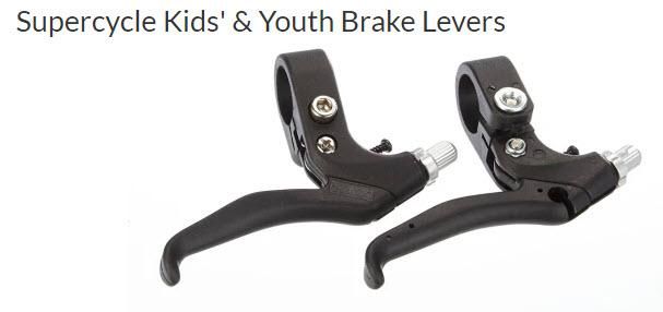

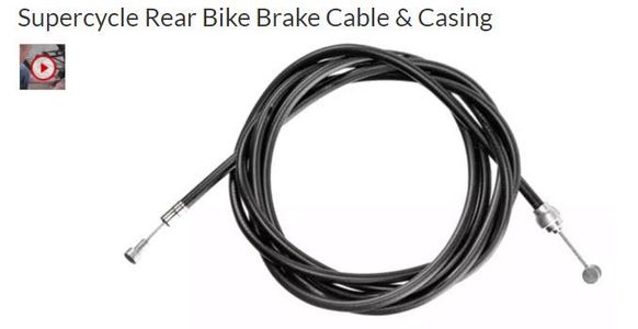

The speed control is done with a bicycle brake lever and cable. If you don't have an old bike to pirate, get a cable that is at least 175 cm / 6 feet long. My cable was not adjustable, but that would be preferable.

Use your dremmel to cut slots for the brake cable (only if yours already has the lead stoppers on both ends)

Mount the brake lever on the plywood with three flat head screws - tighten the hex nut.
Obviously the brake cable goes between the foot pedal and the trigger mechanism!
