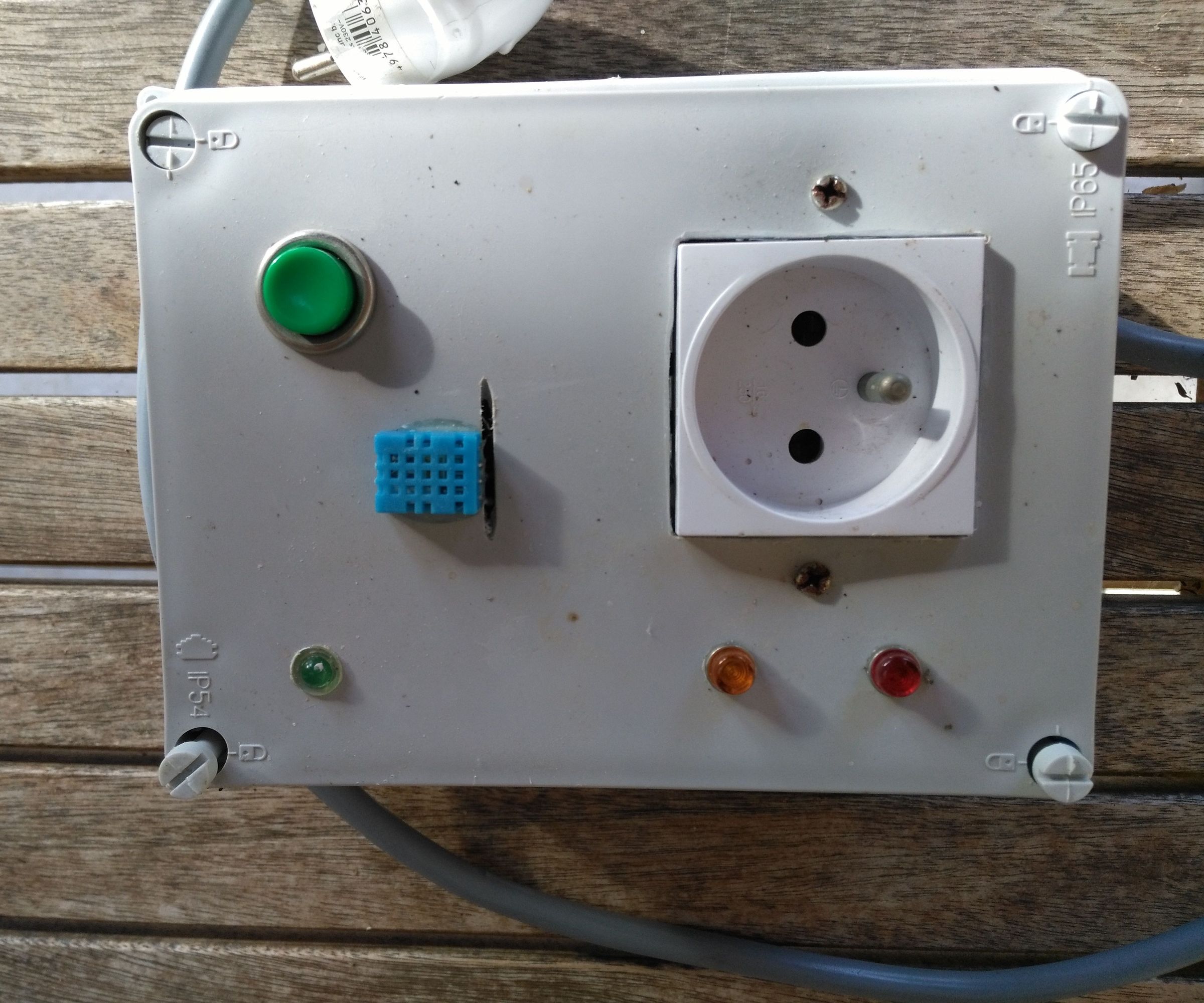

Step 3: Control Box Hardware and Construction
An Arduino UNO board is used as the brain of this system. Everything is powered from a 3A 12vdc power supply (which is actually an old external hard drive power supply).
The UNO board is fully capable of running the necessary relays, completely for this project, but we decided against this. We use the UNO to do the 45 and 15 minute timing, and check the proximity sensor, then drive a shutoff relay if a fault is detected, but the actuator itself is driven by a dedicated DC motor delay reversing drive board.
Why would we do this crazy thing ?
By using the UNO to trigger a programmable delay motor drive board, the basic program timing, and length of time that the actuator is driven, are separated. The exact actuator driving time can be tweeked easily without having to re-programme the UNO.
This is important because the actuator position is only determined by the length of time that the actuator is driven. During testing you will see that the actuator drive time needs to be adjusted slightly depending on the load on the bed. The actuator drive time can be tweaked at 0.1 second accuracy easily via push buttons on the motor drive board. This is way easier than reprogramming the UNO for each minor adjustment.
Manual mode is achieved purely by switches and wiring. We found it necessary to disconnect the automatic motor drive output during manual operation because the motor drive board shorts out the motor supply when not powered :(
Safety : A 2A fuse is used to protect the actuator output from electrical overload.
Notes about components used
Actuator : This is a standard 12vdc 100mm extension actuator, rated for 750N force. It moves at 10mm/second which is about as fast as you want. You may need something stronger and slower. Usefully, such actuators have internal limit switches so you don't have to worry about driving the motor past the end of travel for a few seconds. By the way, try and buy an actuator that is described as being low noise !!!
Sensor : This is a cheap 3 to 5v, 3 wire, IR adjustable proximity sensor from EBAY. It can be connected to an Arduino UNO digital input to give a high/low signal when adjacent to a hard object. Power supply comes from the UNO board.
Motor Drive Board : The board has logic inputs (GND is the trigger) one for each motor direction. The UNO triggers these inputs. When an input is triggered, the board applies power to drive the actuator motor in either direction (depending on which input was triggered) for a pre-programmed time period (selectable 99 to 0.1 seconds). This time period is memorized by the board. It is powered directly from the 12vdc supply.
List of Main Components for the Control Box
Arduino (the brain) : Mounted in the box so that the USB connector is still accessible (for re-programming !)
12v relay board (Manual relay)
5v relay board (Fault/shutoff relay)
DC 12v Digital LED 3v-14v Motor Reversible Module Programmable Relay Control PLC (from EBAY).
Re-setting 2 A fuse (to protect against actuator overload faults)
DPDT toggle switch (OFF/Man/Auto selector)
DPDT momentary toggle switch (Manual mode control)
Latching pushbutton switch (to select extra dwell programme)
Handful of LED indicators (useful to have on the control panel for troubleshooting, but not essential)
