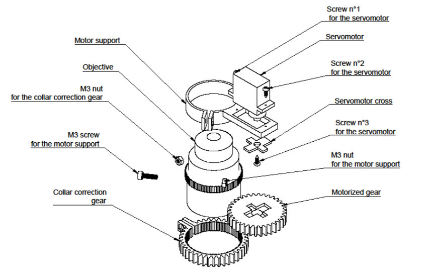

Step 2: The Objective: All the Parts
After the article Easy Exploded 3D Drawings of JON-A-TRON, I could not resist making my own gif and drawings.
Below you can see how the pieces are connected:
And on the image below the drawing with the nomenclature.
As you can see, the motor support was inspired and modified from this article . However, I have changed the way to attach it to the objective, and the gears module.
Also, note that the "servomotor cross" and the "motorized gear" are just assembled together without a screw.

As you can see on the right of this picture, the original teeth of the objective gear were really small. I have tried to 3D print a gear with the same module, but of course, it does not work well... So I have made a ring gear to place on the gear of the objective. The inner part of the ring has small teeth to grip to the objective gear, while the outer part has bigger teeth.
Step 4: The Objective: How to Attach the Gear?
To attach the ring gear and the motor support to the objective, I have used a system similar to a hose clamp, with M3 screws and nuts. This way, the parts are strongly attached to the objective.

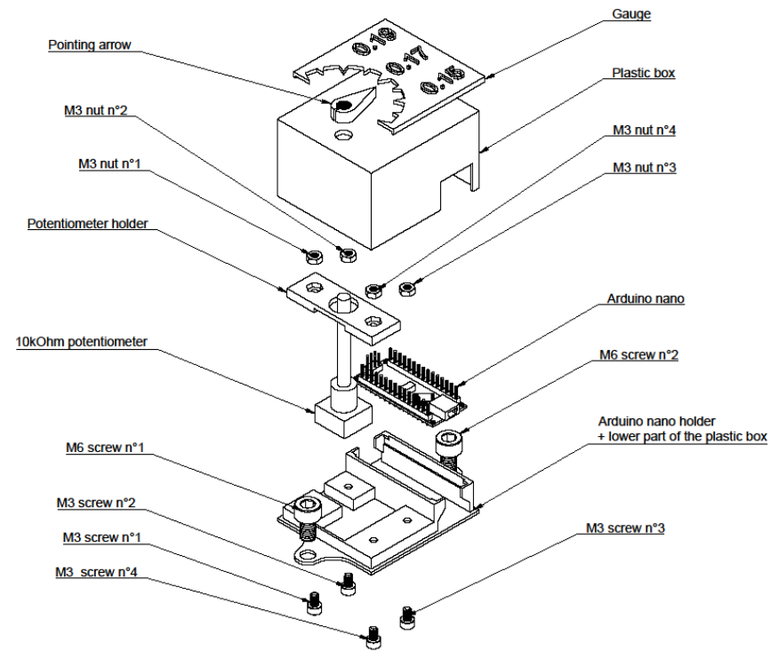

Step 6: The Controller: All the Parts
Again, below you can see how the parts are assembled.
On the image below, you can see that the M3 screws and nuts are used to hold the potentiometer, and close the box (attach the lower and upper parts of the box). And the M6 screws are used to fix the box on the optical table where the microscope stands.
The "gauge" part is the only piece that has been glued (to attach it to the "plastic box"), and I have used cyanoacrylate glue.
