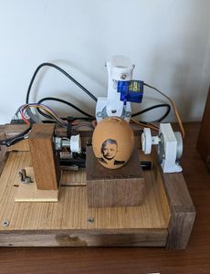

I've always wanted to make an Egg-bot for creating art on an egg. I've seen multiple "instructables" and "DIY kits" for creating an "EggBot" or "SphereBot," but I've never been able to get one to work. Most of the instructions use a wonderful tool for CNC called "GRBL." GRBL uses G-code to drive bipolar stepper motors. I've looked for a GRBL derivative to use on a unipolar stepper set, but the software is archaic and is difficult to get working.
I recently built a "Motorized Etch-A-Sketch," from the author steve_a. Steve's research and beautiful python coding make it easy to create an image on an Etch-A-Sketch. I looked at Steve's code and found it to be exactly what I was looking for.
I'm kinda cheap. The unipolar steppers, 28BYJ-48, and their control boards, ULN2003, are perfect for the hobbyist such as myself. I looked into buying another Raspberry Pi Zero (RPi Zero) and found that they are hard to come by. The RPi Zero is at a pretty stiff price for someone as cheap as myself. I had an old OrangePi Zero (OPi Zero) laying around which is cheap but powerful enough to drive the project. I loaded Debian on the Opi Zero and Hacked -- with some great difficulty -- Steve's code to create the Motorized Egg-A-Sketch.
Our local "maker space," the Inventor Center was hosting a "Ukrainian Egg Dying Class." I HAD to make the Zelensky Egg shown in the Title. What's more Ukrainian?
This tutorial is not so much about the apparatus used to hold the egg. There are several Eggbot, Sherebot, Egg Painter,... plans out there. Sadly, most use the bipolar steppers. I DID find a few 3D printable versions using the 28BYJ-48 as the main stepper set -- mostly on Thingiverse using the software I couldn't get to work:

I built a wooden frame and modified the arm parts of one of these models to fit my device. My first attempt was a failure due to the lack of clearance of the drawing arm. I had to totally re-build the frame. I use sticky-tac to hold the egg in place on the wheels. It allows much less pressure on the egg-- especially if it's raw... EEEWWW!

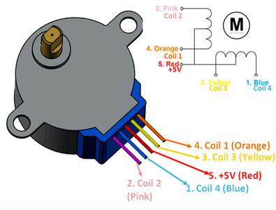

2 28BYJ-48 Steppers that should come with the ULN2003 controllers

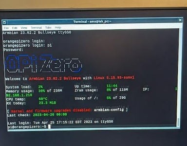

Step 1: Install Armbian on Your OrangePi Zero
Install Armbian on your OrangePi Zero
There are a number of instructions on how to get Armbian on your Orange Pi. Rather than re-inventing the wheel, please look up and follow instructions for your OS.
The Egg-A-Sketch runs on a very lightweight OS of Debian Linux for ARM processors called, Armbian. If you are familiar with Ubuntu, Debian, or other deb-package management versions of Linux, you will have no problem.
I will try to make this instructable as easy as possible for the average layman on Microsoft Windows as well-- but the Egg-A-Sketch will run on Armbian, and their will be many commands in Linux. Have patience, take your time, and follow the instructions. It should have good results.
  1. Download the latest stable version of Armbian from here.
  2. Etcher (Balena) is the easiest tool I can find to burn an image. Use Etcher to create the SD card. If you are a linux guru, and "dd" is your thing, use it instead.
  3. Boot
Linux Users
If you are a linux user, put the SD card in your OPi Zero, and connect the USB cable to a USB port in your computer. You can find out which port your OPi Zero is connect as root with--
# dmesg
-- is a message log of recent hardware changes.
Towards the end of the log, you should see something like 'ttyACM0' or 'ttyUSB0', which is your serial port.
With '/dev/ttyACM0' as an example, type in--
$ screen /dev/ttyACM0 115200
-- will bring up the OPi Zero connection.

First Time Login
Be sure to immediately change your "root" password. For all practical purposes, this does not need to be a serious password unless you plan on using the OrangePi Zero for more than an Egg-A-Sketch. I wouldn't think anyone would want to hack into your Egg-A-Sketch to wreak havoc on an egg. If you plan on using it for more than an Egg-A-Sketch, use the safety standard "...at least 8 characters including at least one capital letter and some special characters and never any dictionary words ...." .. But for the Egg-A-Sketch, use something you can remember and is fast, like "orange," or "egg."
Once the root password is set, your Armbian version may want you to create a user as well. When I used steve_a's software, he went with the standard user,"pi". I would suggest you do the same, unless you want to hack a bunch of code. I have some specific privileges for the user, "pi," built into the download. Create a password again, and you should be ready to move on.
The script will move to setting up the shell. I use "bash." It's an old standard. There are a few differences are between "bash" and "zsh."
You can now set the Network connection-- "easy peasy." If you want to change it later, I'll show how that is done later in the instructable.
It will ask you for a Timezone. It will then go to "locales." for the language. I'm in Eastern US so en_US.UTF-8 is perfect.
Congratulations! You are running Linux on an Orange Pi Zero!!!

Step 3: Hardware Assembly
It's time to put all those wires together into something usable. Using the diagram above, connect all of your hardware to the OrangePi Zero. Take your time. Relax, you're almost finished.

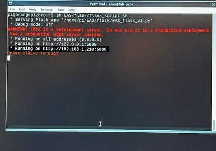

Now Test Flask
In terminal two, log in as <user> again. Type--
$ sudo sh EAS/flask/flask_script.sh
--this starts the flask web server.
Note the highlighted, second to last, line. You should be able to use a web browser of your choice, and type in that address with a beautiful web page designed by "steve_a".
