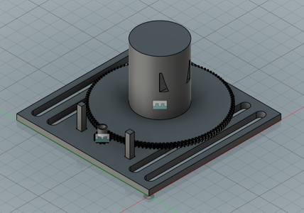

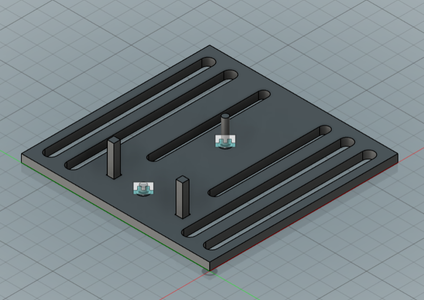

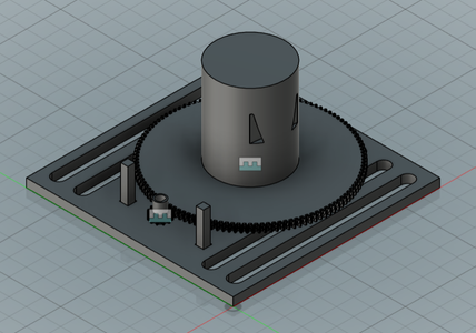

For the base, the purpose is to mount the motor and to gear it down to be slower, higher torque. To accomplish this using the motor linked above, a 10:1 ratio is required. I partially used gears I found on Thingiverse under a creative commons license and adapted them to be as shown above. If you copy the generic design shown in the CAD photos you will be well on your way to completing this project.
Tips:
  1. Use 100% infill for all gears and structural components, 30% for all other parts.
  2. Depending on the quality of your printer, you may want to use slower settings for all the prints as some of the part tolerances are tight and going too fast could lead to parts not fitting correctly.
Step 2: Assembling Parts
Base Assembly
Depending on how you design the base, assembly will look different. But for my design, the 2 gears will simply slide into place and should match perfectly without any further attention needed. We are now ready to work on the electrical and mount the motor onto the gears!

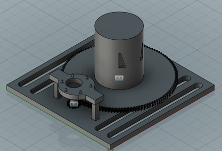

Motor mounting
To mount the motor, the only thing of importance is that your gears align perfectly and all parts are the correct tolerance to fit with the motor.
Attaching to the sprinkler
To attach the driven gear to the sprinkler, grab some fishing line (I used 30lb strength line) and tie one end to the sprinkler and the other to the driven gear through a small hole, an example of which can be shown in the CAD photos above.
