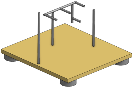

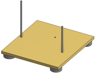

First, cut out a 5.5" x 6" piece of plywood if you have not already. Then, drill three 5/32" holes through the plywood at the locations designated above.
Flip the piece of plywood over and add a small furniture pad to each of the four corners. Flip the plywood back over and set it aside for a moment.
Now cut off two segments of lengths 3.75" and 2.75" from the 1/8" diameter metal rod. Take the plywood and place it in the orientation shown in the picture above on the left. Put the 3.75" rod in the left hole and the 2.75" rod in the right hole. Hot glue them in place. Leave the center hole empty for now. When finished with this step, your project should look like the picture above on the right.

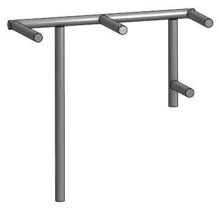

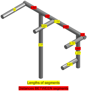

Begin by assembling the four gears and cutting the remaining metal rod into 0.65", 0.75", 0.85", 1", 1.25", 2.5", and 2.75" pieces. Assemble the metal rod pieces into a gear train scaffold as shown above. Connect the pieces using a soldering iron and some solder, a hot glue gun, super glue, or other adhesive method. Which method works best will depend on what specific material or type of metal you are working with. When I built mine, it worked pretty well to solder the pieces together and then coat the joints in hot glue. Where exactly you connect each segment will completely depend on what type and size of gears you are using. I recommend placing the gears that you are using on their corresponding segments while you are connecting them in order to give the scaffold the correct structure and ensure that all of the gears will be able to run smoothly. Feel free to use the measurements in the picture above, but remember that these numbers are estimates that will not necessarily apply to your project. Just focus on the overall structure and use the gears that you have to shape it.
Once you have fully assembled the gear train scaffold, hot glue it into the center hole of the base from Step 1. When finished with this step, your project should look like the picture above on the bottom right. It is a good idea to put the gears on at this point so that you know that they fit correctly and run smoothly together. Make sure that you are able to place the motor with its gear attachment somewhere on the base so that it is able to turn the bottom gear. If it doesn't quite work, move the gear train scaffold up or down a little bit until the motor can connect to the gear assembly.

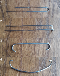

Gather 9 paper clips as well as the 3" x 3" cardboard square and have your hot glue gun, pliers and soldering iron (or superglue) at the ready for this step. You will also most likely need some small wire cutters or scissors to cut the paper clips.
First, take 6 of the paper clips and straighten them out with pliers as seen in the first picture above. Then, clip off the excess part of the paper clips and use pliers to bend the curved end downwards at a 90 degree angle as seen in the second picture. Your metal marble should be able to roll all the way through each of these paper clips without hindrance.
With the remaining 3 paper clips, cut them so that they look like the third picture. Then, put a slight 45 degree bend in each of them, as seen in the fourth picture.
