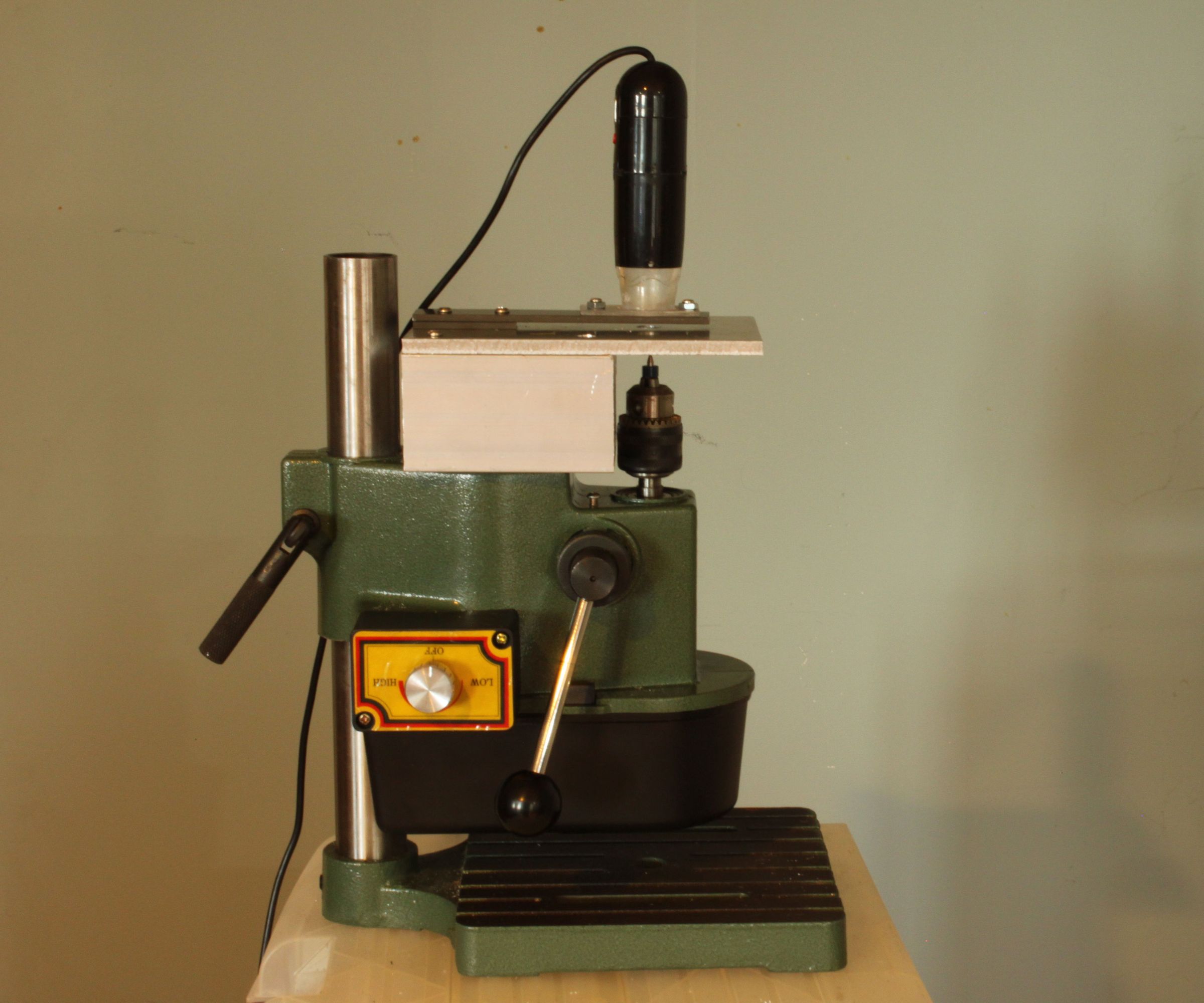

Introduction: Motorized Plunge PCB Drill Using a USB Microscope
This Instructable is an improved version of the USB Microscope Guided PCB Drill I published HERE.
The subject of PCB drilling has come up many times on the Homebrew_PCBs Yahoo Group. Among the many interesting thoughts was Harvey White's description of the PCB drill he had constructed using a TV camera and a homemade drill that drilled holes from the bottom of the PCB rather than the top. It also featured a stepper motor driven Z axis carrying a high speed rotary tool as a spindle.
The main advantage of bottom-up drilling is that dust from the drill does not obscure the camera's view. A secondary advantage is that the camera does not have to take up a lot of space below the drill table. In the original Instructable I detailed my build of a USB Microscope Guided PCB Drill in the inverted configuration using an off the shelf drill press and having a manual Z axis.
After using the manual drill awhile, I found that it was very cumbersome to hold the pcb with one hand while simultaneously pulling up on the feed lever to drill the hole. So I decided to modify the PCB Drill to include a Motorized Plunge.
I also found that the bar cantilevering the microscope over the plate was not rigid enough to keep it from flexing while I was focusing the microscope. I decided to replace the aluminum bar with a steel bar of the same dimensions. The Spacer between the Bar and the Plate can be either steel or aluminum. The only problem this presented was in threading the 4-40 holes to attach the microscope mount. I found that unless I was really careful (and lucky), the 4-40 tap would break. So, in this version of the drill I used 6-32 screws instead. I suggest you use a good quality tap, plenty of lubrication, and take great care to be sure the tap is vertically centered in the hole.

Step 2: Making the Drill Arm, the Motor Lever Arm and the Motor Plate
Remove the 4 screws holding the aluminum Plate to the Rectangle and put it aside.
Unscrew the Hand Feed Lever from the Spindle Wheel and discard it.
To make the Drill Arm, drill two 7/32 (.219) holes 30 mm apart in the 10 inch x .25 x .625 steel bar. Clean and deburr the holes, then use M5 x .8 pitch x 20mm long bolts to attach the lever to the 20mm shaft collar. Drill a 3/32 (.09375) hole .75 inches from the other end of the Drill Arm.
The motor I have has an 8mm diameter shaft. To make the Motor Lever Arm use either a 5/16 or 8mm drill to make a hole .5 inches from one end of the .250 x .750 x 6 inch aluminum bar. Drill a 7/64 (.109) hole from one edge of the bar into the 8 mm hole hole and tap for a 6-32 setscrew. Drill a 3/32 (.09375) hole .5 inches from the other end.
File the edges of the 4x4x.125 Steel Plate. Assuming you have the same motor as specified in the parts list, drill all the holes as shown in the drawing appended below. If you have a different motor you will have to modify the drawing as necessary. Once you have drilled the holes, tap the two .109 holes for 6-32 screws. Be careful not to break the tap! Be sure the tap is centered vertically and use plenty of lubricant. These holes are accessible from the rear, so another option would be to drill them to clear the 6-32 screws using a #25 (.1495) drill and use nuts and lock washers when you mount the Speed Controller Box.
Since the motor’s measurements are in metric and I (mostly) use imperial measurements, the Motor Plate drawing is imperial with metric value being converted to decimal equivalents.

Step 7: Mounting the Drill Arm, Motor Lever Arm, Limit Switch and Magnet
Loosen the shaft collar on the Drill Arm and slide it over the Spindle Wheel in approximately the position shown in the photos. Tighten the shaft collar.
Place a 6-32 x .250 inch setscrew into the Motor Lever Arm and slide it over the Motor Shaft. Center the Lever Arm on the Nylon spacers but do not tighten the setscrew.
The Limit Switch is used to sense when the drill has moved far enough to completely drill through the pcb. I decided to use a magnetic reed switch because it is much easier to adjust. Reed switches are activated by the presence of a magnetic field, in this case by a rare earth magnet mounted on the Motor Lever Arm. The Limit Switch is mounted to the motor as shown using an M4 screw. Note the tab on the Limit Switch has to be drilled out slightly to clear the screw.
To adjust the Limit Switch, place an ohmmeter across its leads. You will now be swinging the Lever Arm to determine exactly where to place the Magnet to trigger the Limit Switch. Hold the Magnet on the Lever Arm and slowly rotate it till the switch closes. You want the switch to close just a little before the lever Arm hits the lower stop. Use a piece of double stick tape to secure the Magnet, then tighten the setscrew on the Lever Arm.
Step 8: Adding the Linkage and Return Spring
Use a piece of .072 inch Brass Rod to connect the Motor Lever Arm and the Drill Arm. Loosen the shaft collar on the Drill Arm. Make a right angle bend about 1.5 inches from one end of the Brass Rod and a second right angle bend in the same direction about 4.5 inches from the first. Cut the rod about 1.5 inches from the second bend.
Cut a 5 inch length of spring. Use a wirecutter to separate a few turns at each end of the spring to form an eyelet. Slide an end of the Brass Rod through the hole on the end of the Drill Arm, then slide a spring eyelet over the rod. Following the photos, use a 1/4-20 bolt and nut to secure the end of the rod. Drill a 9/64 (.141) hole in the upper left corner of the aluminum Rectangle as shown, then secure the other end of the spring to the aluminum Rectangle with a 6-32 screw and nut. See the Photos.
Slide the other end of the Brass Rod through the hole in the Motor Lever Arm and use a 1/4-20 bolt and nut to secure the end of the rod. This completes the linkage, but it still must be adjusted.
Put a drill bit in the chuck.
Important! For this drill to work properly all of your drill bits must be the same length. I routinely use carbide drills with "rings" (see photo). The rings allow me to insert each drill exactly to the same depth in the chuck.
Replace the Aluminum Plate, Bar and Microscope Mount.
Put a hex wrench in the shaft collar setscrew. With the spring pulling the Motor Lever Arm to the upper stop, use one hand to lift the Drill Press Spindle at the pulley. When the tip of the drill is just below the surface of the Aluminum Plate tighten the Shaft Collar. You should find that rotating the Motor Lever Arm to the lower stop will raise the drill so that the tip of the bit will be well above the Plate.
If necessary, you can adjust the trigger point of the Limit Switch by rotating the Limit Switch on its mounting screw or by moving the Magnet. If you use an ohmmeter with the Motor Lever Arm rotating the motor, keep in mind that the emf generated by the rotating motor can "fool" your ohmmeter. Don't use the "beeper", look for (approximately) 0 ohms as the switch closes!

Step 10: Using Your PCB Drill

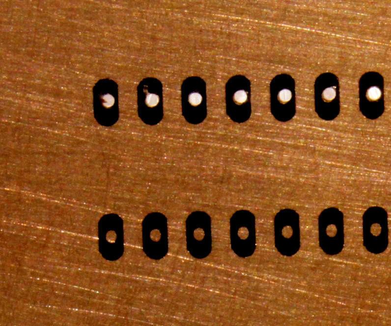

The drill is designed to use the 1.5 inch long carbide drills commonly used to drill PCBs. These drills have a .125 inch diameter shank and come either with or without depth rings. I strongly suggest you use rings - it makes positioning of the drill bit MUCH easier!
Since the spindle is so close to the plate, it is necessary to completely open the chuck and "wiggle" the bit into place. Once you’ve done it a few times it’s pretty easy.
For "final" calibration of the Microscope loosen the screws holding the Microscope. Connect the Microscope, open the software and turn the LEDs on. Raise the spindle so that the tip of the drill just passes through the plane of the Plate. Focus on the tip of the drill point and center the tip in the crosshairs. Now tighten the Microscope screws. Recheck the calibration and loosen the screws and redo if it is not in perfect alignment. After using the drill a while, I noticed that the vibration of the drill had a tendency to shake the Microscope out of focus. This is easily remedied by focusing on the PCB then putting either a piece of tape or a rubber band around the Microscope and focusing knob.
Your drill is now ready for use!
The drill can handle PCBs up to about 4.5 inches wide. To drill, insert the proper drill bit, start the drill, turn on the Microscope and set the software to Full Screen. Carefully position the crosshairs on the center of the hole. Hold the PCB firmly in place with both hands, and gently press the Footswitch. You should have a perfectly centered hole! The final photo shows a .021 hole perfectly centered in a pad.
