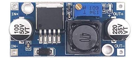

  6. Buck Converter for the motor driver, $1.60 each: https://smile.amazon.com/gp/product/B07VVXF7YX/ref=ppx_yo_dt_b_search_asin_title?ie=UTF8&psc=1

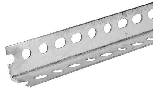

  8. Slotted angle metals.

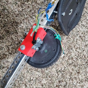

Step 1: Build the Frame and Motor Mount
  1. In general you can attach the motor anyway you desire, this is just an example. The focus of this Instructible is on the electronic side.
  2. Cut the slotted angle metal to length.
  3. 3D print the parts from my Thingiverse for the framing supports and mounting the hoverboard motor https://www.thingiverse.com/thing:4980209
  4. Drill two holes on a ripstik to fit 5/16 bolts as shown in the picture.
  5. Put the bolts and nuts as shown in the pictures.
  6. The last picture is the finished product. I leave the back wheel for safety reason. When place on a flat surface, the motor is below the back wheel, therefore the back wheel is above the ground. Stepping on the ripstik put a pressure on the motor for traction.

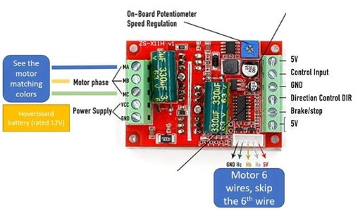

Unlike a standard DC motor, brushless motors are controlled differently. DC (brushed) motors typically have (+) and (-) terminal which you apply a voltage. Brushless motors on the other hand, are driven by pulses at different phases, three phases in this case.
The 1st picture shows the wiring diagram of the motor driver. Additional wiring information:
  1. Short the "Direction Control DIR" to GND so the motor only rotate one direction (forward).
  2. Brake/Stop can be connected to a push button switch and connect it to 5V.
  3. Instead of using the motor driver 5V to connect to Wemos 5V, use the Buck Converter because it is more stable:
  4. Use the Buck Converter (+) output.
  5. Dial the Buck Converter until the output voltage is slightly higher than 5V for more margin should the voltage dip occasionally. I dialed it to 5.2V.
  6. Connect GND to Wemos GND
  7. Connect GND to Buck Converter output GND (or negative (-) output).
  8. Connect the 1MOhm resistor between GND and the Control Input. This is a Pull-Down resistor for safety and only allows the motor to run when you step on the front part of the ripstick. See the 3rd picture.
  9. Connect "Control Input" to one of the push-button switch pin. Then connect the other pin to the to Wemos D3 pin. The push-button is placed on the front of the ripstick. When it is not stepped on, the 1MOhm resistor pull the Control Input to GND. When the push-button is stepped on, it allows the Wemon D3 output signal sent to the Control Input, to run the motor.
  10. The battery can be higher than the hoverboard's battery. The driver is rated up to 60V and I use a 40V power tool battery.
  11. You can add a toggle switch for the battery, make sure it is rated for high current, instead of plugging the battery to power on.

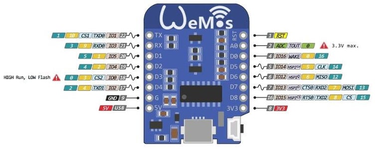

Next: upload the following Arduino code to the Wemos:
#include <ESP8266WiFi.h>
#include <Arduino_JSON.h>
#define PWM_PIN     0   // D3
#define BREAK_PIN    5   // D1
JSONVar    myJSON;
WiFiServer   server(5001);
WiFiClient   wificlient;
String     request;
int      Magnitude;
unsigned long last_no_signal = millis();
boolean    Break, last_Break;
void setup() {
 pinMode(PWM_PIN, OUTPUT);
 pinMode(BREAK_PIN, OUTPUT);
 digitalWrite(BREAK_PIN, LOW);
 Serial.begin(57600);
 analogWrite(PWM_PIN, 0);
 WiFi.softAP("Ripstick", "anypasswordyouchoose");
 Serial.print("AP IP: "); Serial.println(WiFi.softAPIP());
 server.begin();
 analogWriteRange(1023);

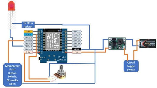

Step 3: Remote Control
  1. The remote control parts can be 3D printed from my Thingiverse: https://www.thingiverse.com/thing:4980209
  2. See the schematic picture of how to wire the remote control.
  3. Dial the Mini Buck Converter until the output voltage is around 5V (or slightly higher).
  4. The LED is used as an indicator when the Wi-Fi connection to the motor Wi-Fi is established which is when the LED is blinking.
  5. The potentiometer is used to control the speed or power of the motor
  6. The momentary push button switch is used for the brake.
  7. The toggle switch is used to power the remote control on and off.
