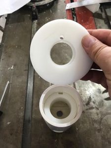

Prepare the lower servo housing half by countersinking the two holes. Attach it to the servo housing top with the two long screws (The two screws MUST sit flush). Test fit this into the white tube. If it doesn't fit, you may have to sand it.
Next, take the flange bushing and make sure it is able to slide onto the grey tube easily. This needs to be fit inside the white tube as square as possible and the grey tube needs to be able to rotate freely inside of it. Sanding (or lathe is handy) work may be required. Take your time as this piece needs to operate smoothly with no binding! It needs to be able to plug flush into the bottom of the white tube and the grey tube needs to be able to rotate in it smoothly. You don’t want it tight at all, but you don’t want it so loose that it wobbles.
**Note - I combined a couple parts from earlier drawings and made the updated bushing and flange collar into one piece. Easier to assemble.
Next, select which model you are choosing. There are two different torso collars - They are labeled in the pic above.
Take the lower flange and the torso collar and fine sand their mating surfaces. You want them to rotate/slide easily with no resistance.
Make sure the grey tube can fit into the collar. Sand or lathe as needed. This fit can be tightish as we will attach it to the tube.
Upgrade Option - Use a lathe to make the Flange Bushing out of HDPE, Nylon, or Delrin plastic to be much more smooth and slippery. This allows easier motion and exact fit.

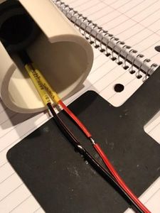

Time for the power wires! *** NOTE!!!! - For some reason, they swapped the plug polarity on the skelly and the inferno models, so make SURE you use the right one or this won't plug in correctly when you are done!!!. Run the plug through the top servo housing hole. Run the other plug up through the torso ring and bushing flange. (NOTE - Make sure you select right version either skelly or inferno). continue threading plug wire up through the flange and through the bushing flange hole.
Cut two little pieces of heat shrink tubing and slide onto wire and solder red to red and black to black. Slide heatshrink over joints and shrink it.
Slide the power wire back up and strip two small areas in the each wire to solder the read to the positive pin on circuit board and black to the negative pin. Add a tiny bit of hot melt to make sure they don't touch and to keep wire from being pull the excess back downward so the joints and heatshrink are below the top of the bushing ring so to not interfere with the rotation of the grey tube.
Testing time! Plug in the power wire coming out the area next to grey tube into your skelly or inferno neck plug coming out of torso. Turn the power on using their regular switch. After a few seconds, the servo will begin to randomly move from side to side. Take note of the wire travel in the slot. The torso ring needs to be mounted so the wire doesn't get chopped or crimped as it goes back and forth!
